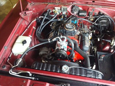

The individual parts start adding up pretty fast. By nature, I am often looking for a way to do something myself for less than just buying a kit. I've never bought a crate engine, I've always built them myself. I've only bought one brake kit, a rear disc setup from Dr Diff. With my limited experience with A/C stuff, I just went with a complete kit.
I could see that the 68-70 B body kit would be about 70 % correct for use in a 66-67 model, the remaining 30 % being the interior controls and the dash ducting. I made a few changes to my setup in the interest of a cleaner appearance.
We would like to keep the interior controls and dash ducting original and not mess with them.
I can understand that.
My heater and A/C didn't work when I bought the car and it wasn't until last year that I drove it in cold weather with a real heater. I never developed an opinion on the stock controls but the mere idea of vacuum and electric controls didn't sit well with me. My control panel looks a lot different than stock but fits in the same spot. That was enough for me.

Kd, you install looks great
Looks like a decent retro-fit kit if using the stock AC / Heater box and controls.
