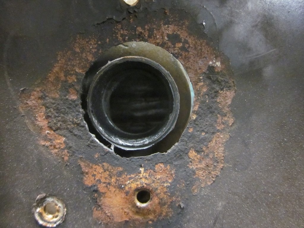

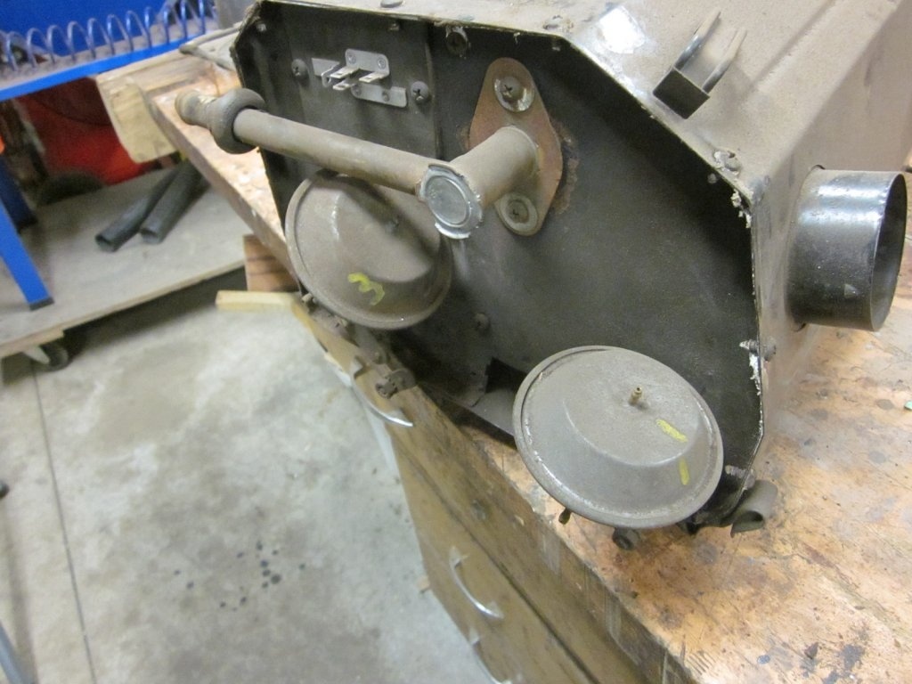

Just wondering if anyone has ever modded the in/outlet tubing for heater cores.
This 64 has a two piece tube which uses o-rings and I think might be prone to leak.
Mine is missing the control valve and I was wondering if something different has ever been uses to replace it and if the tube could have a threaded union, instead of the o-ring. There might not be enough room to add a fitting, but I thought I'd throw the question out there.
I haven't done this before but I've thought very seriously about the same thing when I get to that point on my 64 Savoy. Adapt some type of elbow to the core and add a ball valve or some type of heater control valve to the hard line. As many of these that are out there I would have thought somebody would have figured out a replacement by now.

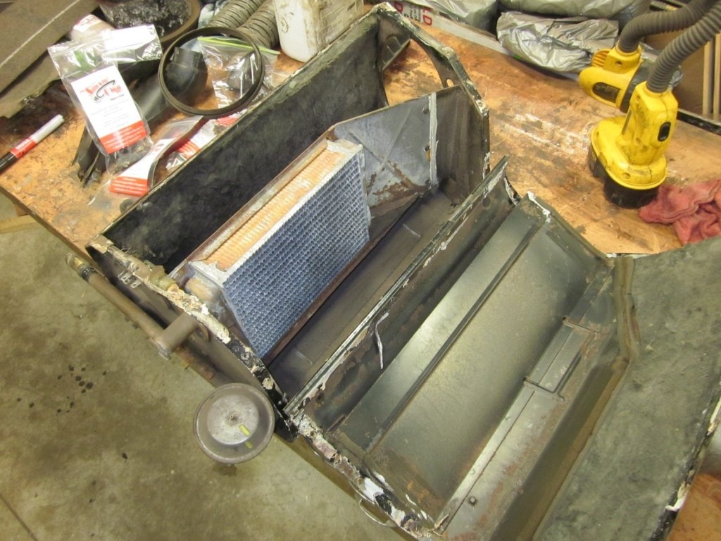

The rebuild kit arrived from DMT today!
Your valve (elbow) appears somewhat different than mine. Napa offers a rebuild kit for the valve, but consists only of a rectangular diaphragm, no o-ring. Could you post a picture of your kit when you get it? I thought all these 62-65s used the same Ranco heater valve. Thanks.
I do not have a valve to rebuild. The kit is for insulation and gaskets for the housing etc.

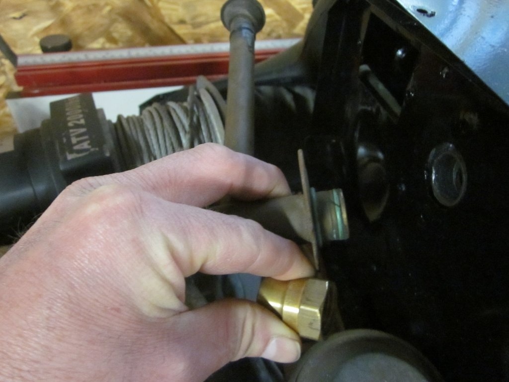

I would think you could find a cable controlled valve at any parts house or online. As far as reworki g the connections I dont see why you could not pull the coil and solder in a 1/2" male or female adapter. Personally I think its a great idea. If you are worried about heating up the joints on the coil itself you can get heat sink paste which will help keep the heat where you want and keep it from migrating...
