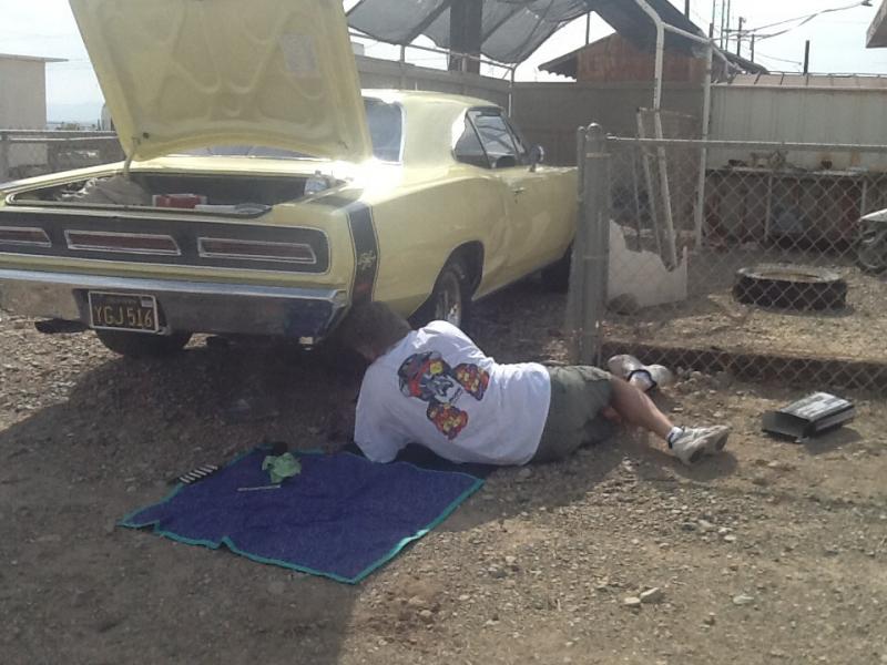

image.jpgThis is my friend Darius installing the replacement pump at Saltan Sea.
