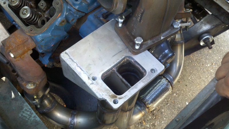

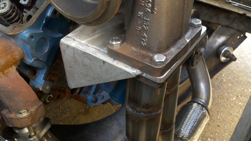

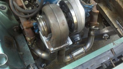

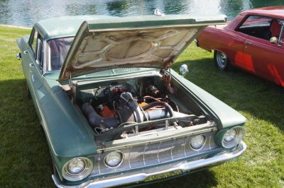

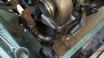

Here's small block single. 10.99@123 at only 8 psi,2.76 gear,2.55/60 drag radials.
Doug
2011-07-24_10-22-42_160.jpg 2011-07-24_10-23-32_740.jpg 2011-07-24_10-25-15_281.jpg 2011-07-24_10-41-23_311.jpg
I was wondering how you did that when I found your picture on google. I'm very confused at the logics of turbocharger but god knows that's the way you wanta go if you wanta make hp in this modern day of racing. I've got a 10:1 built 440 on nitrous but always thought about going turbo. Wheres a good place to learn about turbo setups, calculations, etc... What size turbo you run in those pics? By the way I admire how little bit of tubing you used to make this thing look bad to the bone. Also like the relocation of the alternator. Pretty cool stuff.
I'd put an 88 on it with a t6 frame Put it on e85 and pray for the stock block
why e85? and why no intercooler? What kind of numbers are you making? forged bottom end? internal external balanced? oh the questions I have for this build. Was showing it to a buddy of mine telling him when I break my 440 on nitrous this will probably be my next build. You just take the stock manifolds and swap and flip them?
I never said no intercooler and I like e85 because its becoming readily available and much more stable for a pump fuel and works well in proven turbo combos.
E 85 works fine with no intercooler. A engine that big needs a BIG turbo on a single. A near stock 440 should make over 800. Your biggest problem will be the block. Update on our 360 75MM turbo car. 16psi,3.55 gear,3800lbs has now gone 9.88@138 in street trim.
