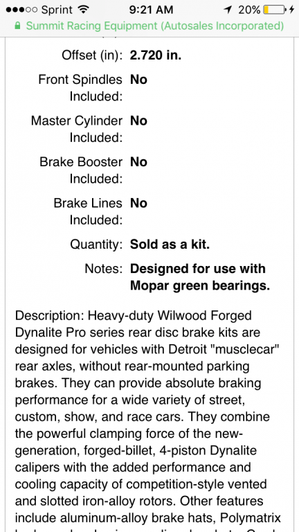

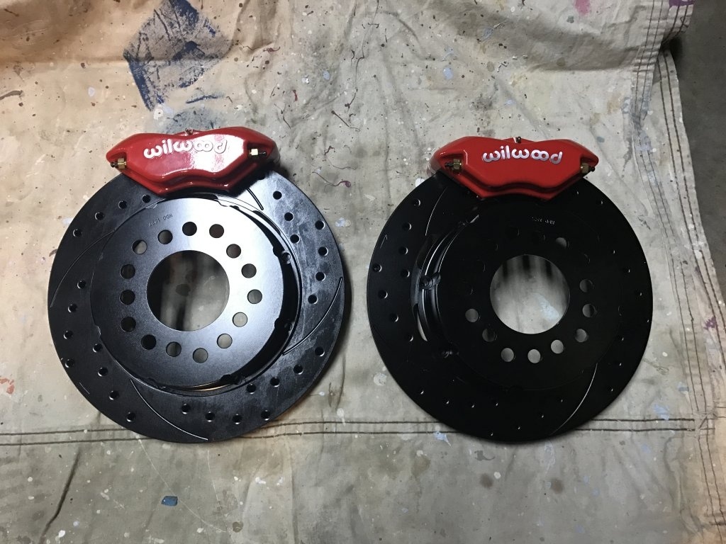

Hey guys, can someone point me in the right direction for mopar green bearings... I bought my wilwood rear disc brakes and it says designed for use with mopar green bearings, not sure wtf that is...

Ball bearings on the rear axles, not taper roller bearings w/adjusters
It looks correct, when I changed over one of the Dana 60 rears I used a competition engineering brand c8008, it looks just like that. I think you are good to go.
you might have to remove the the thurst blocks in the chunk, for the axles to fit properly.
I'm reading the original design, crimped style you want to stay away from, and go with the snap ring style, any thoughts on this?
