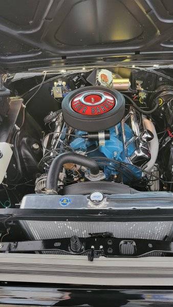

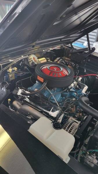

I can tell ya from sperience HP manifolds from a 70 440 Charger R/T are a direct fit into a 65 383 SF with OEM duals.

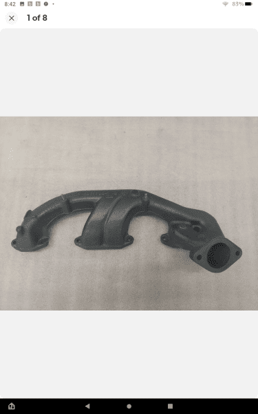

Hp manifolds require a special fastener kit. All threads are 3/8.
kit
