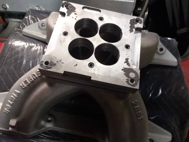

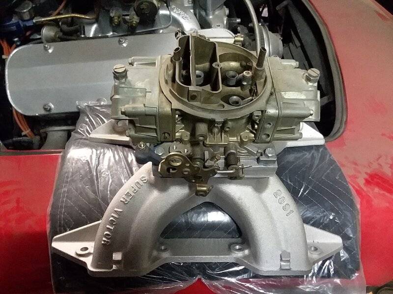

Yep, i bought the 2893 super victor to go with my victor max heads too. Putting mine on a 525. The SV is now $481 at summit, i think i paid more like $400 when i bought mine. I paid $80 for the M1 dominator i bought. I made an adapter so i could mount a known good 850dp, or a dominator, on either manifold
