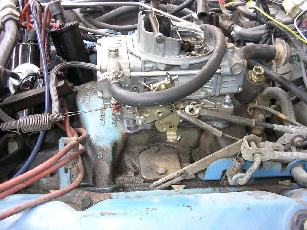

Thanks for the answers. Here's where it all stands. I have sent the Thermoquad to Sparky's for a rebuild. I have replaced the Lean Burn system with a Pertronix distributor with mechanical and vacuum advance and put an adapter on the existing cast iron manifold and have a Holley square bore mounted to it. This only temporary and I plan to go back to the TQ when it returns. All of these parts were available to me from other projects so I decided to see what would happen. I'll know tomorrow. I also have a GM HEI available to replace the Pertronix system if need be. I kind of like the GM fix as I have a lot more experience with them. Basically, all I want to do at this point is get the ignition conversion in place and then I'll sort out the carburetor issue. I have to agree, that after almost 25 years in the retail auto industry, you're best staying as close to OEM as possible.
I am not looking to hot rod this old car, just get it running with a reliable system and to look good. If all goes well, I'll post some pics of what I've done to help others along.
PS, fish, I grew up in Nassau County Lynbrook HS and Hofstra U.
Got it all together this AM and all is working. It's basically put together to see if I could replace the ignition system. The carb is a Holley square bore that has an adapter plate to mate it to the spread bore OEM manifold. The engine fired up on the third crank of the starter. I primed the carb by attaching fuel line to the intake connector and attaching a small funnel to the other end. I poured about a 1/2 cup of gas into that to load up the bowls. I prefer this to dumping raw gas directly into the air horn like we used to do when a car ran out of fuel. It's a bad idea especially when first setting timing as a back fire through the carb can start a fire. BTW, I had a fire extinguisher right behind me.

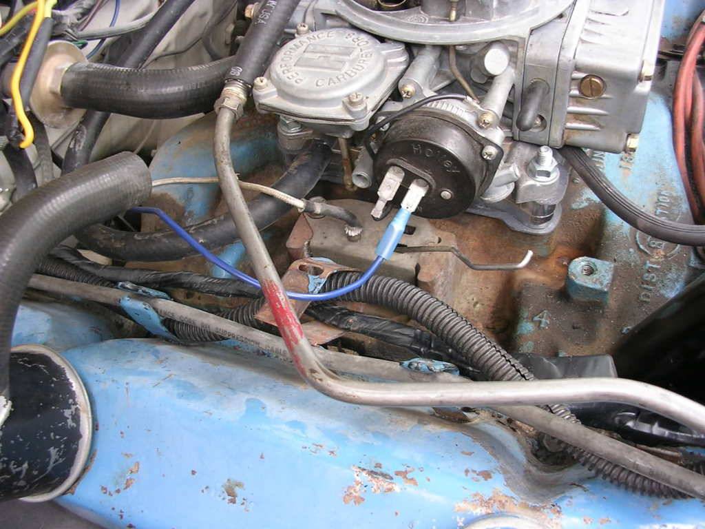

Left side fuel line was all I happened to have on hand so it's a little short. I was only wanting to test the ignition system - which worked fine - so I rigged this up for that purpose. When the Thermoquad returns I will R&R the Holley.
I tapped power from the 12 volt side of the OEM choke heater
