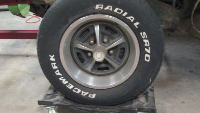

Not sure what you are asking, but let me take a shot: I have 15x8 rims on all four wheels with 245/60R15 and 275/60R15 tires front and rear. The wheels are Wheel Vintiques Magnum 500 style wheels and I added brushed trim rings to replicate the road wheels. Personally, I think they look cool and a bit different than most others running magnum 500s. Not sure if this is what you were looking for?

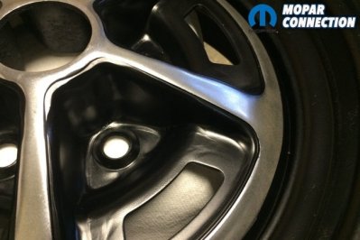

Here is an up close pic of an original wheel. I think a person could have the entire center of wheel powder coated stainless and go back and paint the black using the magnum 500 paint kit that most vendors sell.

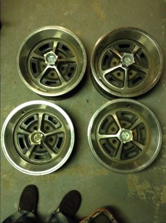

These are a set of magnums 500's 14 inch with the chrome rings if your not sure what to look for
