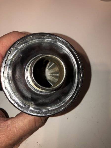

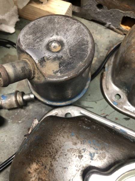

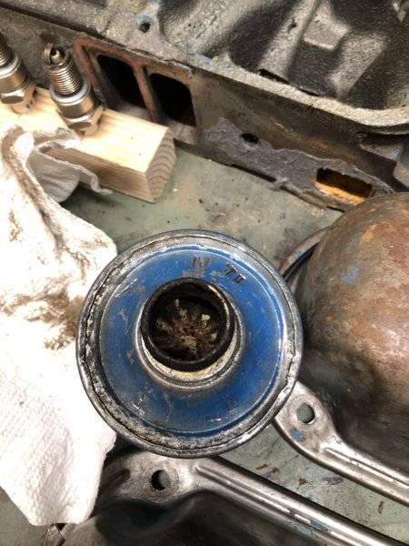

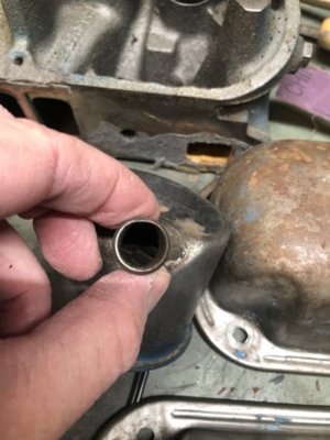

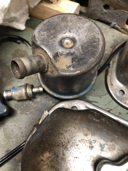

    Trying to not go stir crazy so little bit of hobby time is good medicine for me. Cleaned off my old valve covers such that I can replace the chrome ones which I hate.
    I would like to reuse my 1970 valve cover breather as I like that stock look AND new one are like $50 min.
    Question: Can I clean it out somehow and if so whats a good method?

    If the filter material inside isn't dry rotted and coming apart you can wash it out with solvent like gasoline. If it's the type that doesn't have material inside you can do the same.

      I see dead people.....I mean I see some old nasty filter material. All this thing needs to do is breath lol I wonder if I can breakdown the material with a solvent and have it empty.......

      I put them in my parts washer, which contains mineral spirts and run through it in both directions until clean.

        Does the filter material breakdown, come out or stay intact when you wash it? What solvent ya use?

        The ones I have done look like some kind of course steel wool.

          Always reminded me of something similar to scotch pad. I'd doubt theres any household/garage chemical that would break it down.
          Wash it out. If you see lots of pieces of material, you know it's coming apart. Breathers without material in them use a baffle to keep the oil from coming up into the hose. Some use material and a baffle.

                        I have mine soaking in paint thinner right now. The material inside is thick and strong not like steel wool. As I clean it maybe I can better identify what the f@:?! it is. But it doesn’t look like it will break up. I blew into it before I added the paint thinner and it flows just fine.

                        Spray it liberally inside with carb cleaner and let it soak upside down 15 minutes. Then flush it with brake clean and dry with compressed air. I've done several old ones that way and never had the fiber come out. Wire wheel the outside and paint the outside gloss black and your done.

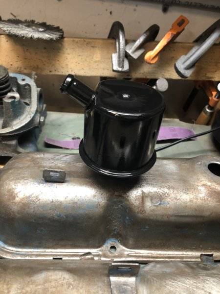

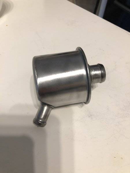

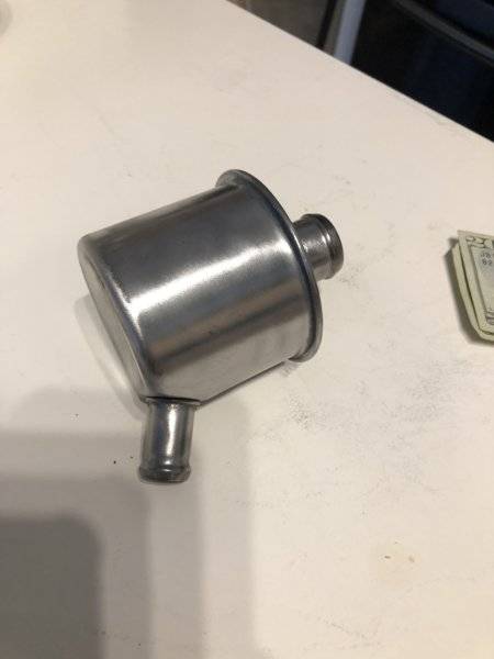

                          Well it cleaned up well. It does not appear to have any steel wool type of filtration but more of a baffle set up as can be seen. I used everything on the shelf to clean it.
                          66F3FF65-EB61-464B-A710-BF0F0E25E2D1.jpeg 734E1907-B1B3-4ED3-A5E8-BD1A7015A56F.jpeg 34C53ACD-9FFC-4FAB-995A-58FF036319EB.jpeg
