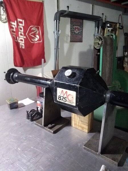

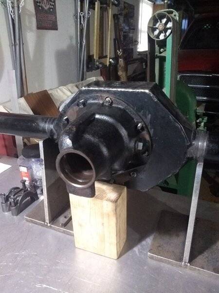

First time to get one that the customer wanted it to be lengthened.....and wanted it to fit the existing axles! Even then I had to shorten them and undercut the splines to make them go into the spool deep enough so as to not shorten the splines too much. Had to lengthen one side to make both axles the same length as per customer since this housing was offset. This is my 2nd Moser setup and well, not too sure I want to do anymore rear ends (especially not Mosers) where the axles have to be modified too lol. Hello Mike!! :D

Man those things are ugly! LOL
What does the vehicle weigh? 1200 lbs? LOL. Good luck
It's going into a 78 Mustang......and from the pics I've seen of it.....I'm thinking the car will fold up before the rear end breaks lol. Hey, If they are paying, I'm playing! :D
