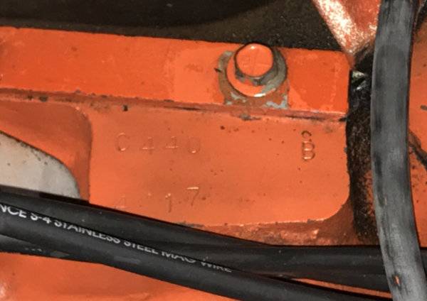

Hello all, I recently purchased a 1969 Dodge Coronet RT. The engine is not a numbers matching motor but everything else on the car is. Colour codes are correct, manual gearbox, dana 60 and all the extras on the car are also correct. The engine is coded as a 440 but it has been replaced at some point . The engine in it at the moment is coded as C 440 B 4 17.

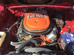

From what I can gather its a 1967 440. Its also had a 6 pack added. These are original 1969 correct carbs and air cleaner not repos as I have had them checked out. My question is this. What would of had been done to the motor to accommodate these carbs. Do they just fit straight on and its a matter of tuning or did the motor have to have some work done to it? I know the 440 came out as a HP as well. Does the motor have to be brought up to HP specs before you can add the carbs? It has an extreme amount of torque and even in 3rd gear at around 50-60mph I can get the rear tires to spin and get a little smoke happening. I have taken it to a mechanic for a tune and he was very impressed on how it ran but since it hasn't been pulled apart for any reason they can't really give me any answers. The car runs extremely smooth and doesn't miss a beat. If someone can give me any info on the 6 pack motors for the RT I would be very grateful. The person I bought the car from imported it from the US in 2010 and the owner had something to do with the Mentor museum of speed. It was purchased for $50 000 US which puts the car in the higher end price range for a non matching motor numbers car. Thanks in advance.

The engine would not need to be modified to accept the 6pack intake. It bolts right on.
The only year a six pack R/T would have been available from the factory was 70 and they were a little different on the bottom end compared to a 69 6bbl.
It sounds like someone took a 67 block and just made a really strong engine.

OK so B on my code pad doesn't stand for a B motor then. This is what has confused me. Can anyone help with the decoding. Here is the pic again. I know C stands for 1967 and the 4 17 is the build date but what does the B stand for.
Rod and main bearings were 0.010 undersized from the factory.
A well tuned 6 BBL motor will out perform a 4 BBL motor. "Back in the day" 6 BBL motors were not very well tuned. A little adjustment on the end carb idle mixture screws made all the difference. But you need to take the small plugs out to get to the adjustment screws. Stock jetting is pretty close.
