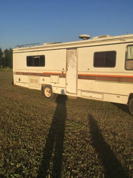

Anybody pull one out? Is it easier to go through the side the front or the bottom. 39k miles 300 bucks delivered to my house. Couldn’t say no. I have sawzall,torch,and a tractor. It looks like it’s gonna be a pain. What kind of internals might it have. It’s probably 10000 lbs 30 feet long
Yes, would be a cast crank, low compression engine, but its still a good 440. It was worth way more than purchase price. At 10,000 pounds they could have scraped it for more than you paid. Your picture didn't show the front, but judging from the style, I think you will pull from the front.
