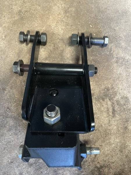

Hi, can I get confirmation that the pictures motor mount bracket will go in the drivers side of the engine bay? This is the bracket with the reinforcement component to it. The tube for the long bolt. Also I saw that the torque spec for the nut that mates the bracket to the motor mount is 75lbs? How are folks torquing that nut? There is no room once the bracket is attached to the motor to get the torque wrench in there and also the mount twist when I attach it to the k-member and torque before attaching to motor. Thank you.
Yes that's the drivers side. I just give them a good whack with the impact.
Should have a fairly heavy washer under the nut from factory.
Ok thanks. I will have to go get a couple washers. Didn’t come with the ones I bought. Is it a flat for locking washer?
