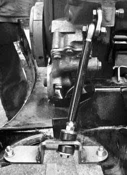

Thanks for the response yatzee, would you happen to have pictures of your set up? I see Mancini sells torque straps, do you know of anyone else?
Thanks.
AR Engineering is your best friend. Check out their site. Hughes is a dealer.

I went a different way and put in solid motor mounts, just like you have now. I looked at the Mancini site & this is basically a "high-tech" chain. Should work just fine for you IMO. Looks like it goes to a long bolt on the motor mount instead of the oil pump housing.

Thank you for the reply, I did a search here (probaly what I should've done on the first place) and found some good info, seems like a lot of people run solid mounts with a torque strap. I am going to go that route and see how it works out. Solid mounts delivered next day by summit! Along with a couple other goodies..

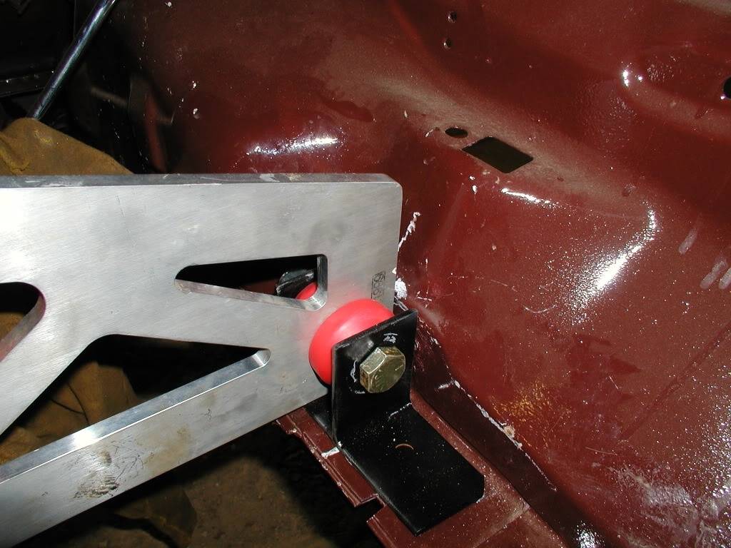

I will probably use a poly mount to lessen some of the vibration and make it a little more streetable. There is a thread about a fore/aft limiter (very cool) that was made that I will use too even though I have a mid plate as well...

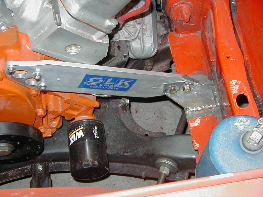

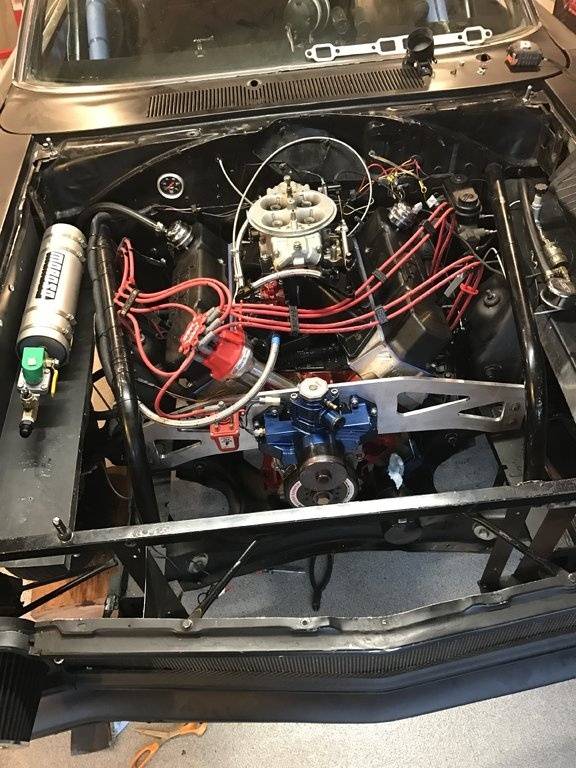

I have a motor plate. AR Engineering profiled. I like the look of the plate. I've had to do a lot of grinding and mix and matching pieces to make mine work as I am also running power steering with a 3 core rad. Its real tight. I haven't driven the car yet. but just letting it idle and rev I don't notice any crazy vibration I isn't normal with open headers.
IMO as a kid seeing the real big power cars using them and sometimes watching the whole car jerk when they rev'd it always was awesome.
Another reason I chose a plate was because my 440 is 060. over and I wanted to reduce the chance of distorting the cylinders with motor mounts.

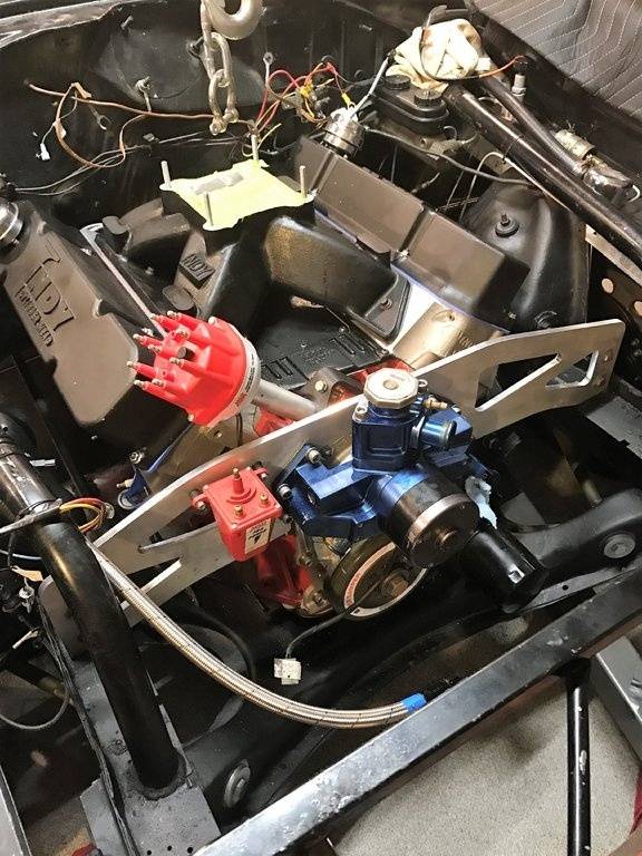

I dont use a strap on my 511 and its in the upper 700 hp range here are some pics.
The water bolt up was perfect with this plate. RTV only no paper gasket

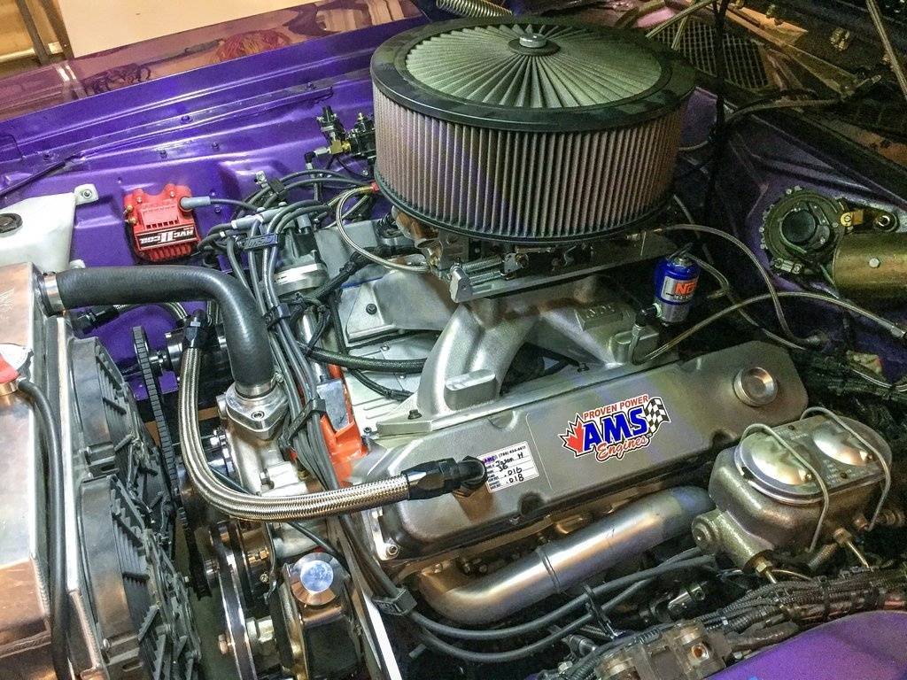

I made my own out of aluminum & did not profile it (taper it) like some of them that are pictured so I had some surface are to mount my accessories to like my vaccuum pump, pump catch can, coil & relays for the fans & accusump etc.
There is mine. Modified slightly to fit the P/S pump for rack and hydro boost.
