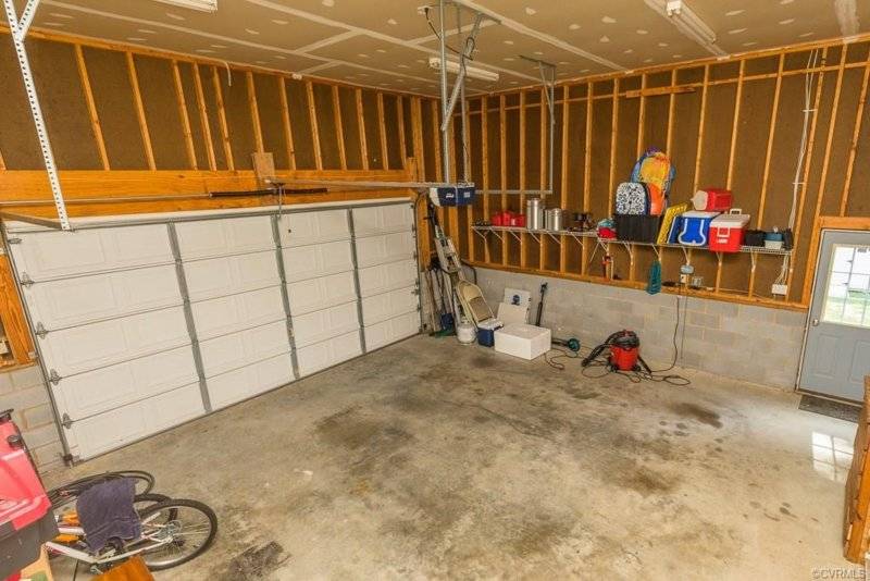

The new shop looks as if it will take a nice 4-post lift!
Step one.. have someone come in and change your door tracks to an angle up. Those door rails will kill the layout ideas and the original installer should have been shot. Congrats on the move and new shop!

And install a Liftmaster torsion door opener.

Looks like he can go with 24 inch, high lift tracks and a torsion bar Liftmaster like @moparwacko suggested and that door will rest up by the ceiling out of his way. Personally, I would get rid of that 16x10 sectional and go with a insulated rolling steel like Wayne Dalton makes. Just my opinion.
Wall and ceiling insulation helps on those cold winter days. And as has been suggested, an insulated garage door helps alot! Good luck!

Yes, Thought I was gonna need to do something with the tracks and change the height of the turn as well. Just happy I will finally will have a lift! Been a long time wrenching on my back. thanks again for the advice. Always appreciated 4sure!

Yes Gary, I agree. I came from a 20x24 Steel Pole building w/8' ceiling (truss) height, Uninsulated and open ceiling and all. Only heated it when in there with a double-wide house trailer furnace using Kero. This is a better design 4sure.
