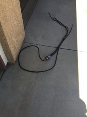

Got that shitty GM Corvette filter/regulator and lines out. The new Aeromotive regulator and lines should be delivered anytime now.
5.7 hemi
11:26 AM
Dec 21, 2008
15,706
14,855
ca
With the new regulator it’s way better. Although I adjusted the regulator, the best psi I can get is 50. So it’s the pump. Nothing that an Aeromotive 340 wont fix, need to get to 58psi. It does run rather well, no bogs, hiccups or stumbling, she straight gets with it. I’m down to 1 code, P0300-random misfire, which I think is fuel pressure related. It’ll be fine for him to drive home and then change out the pump at his convenience.
