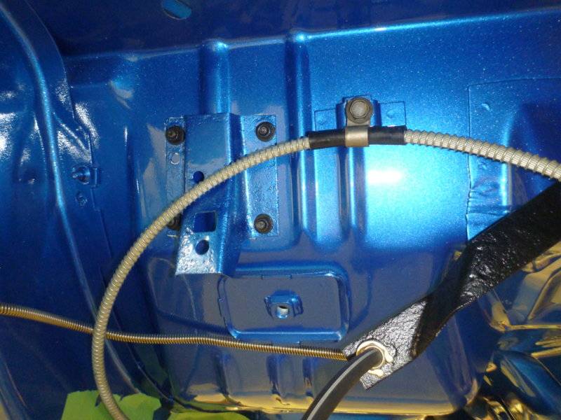

It bolts on, as shown in the FSM.... available from most any supplier. Sorry, I sold the spare I had already...
Passenger side is welded onto EVERY car coming down the line. Only dual exhausts got the bracket bolted to the drivers side. Every part cost money... no point putting it on all of them only to be used on the lower volume duals.
Its easy to install Steve.....Pull the rear seat.....Find the four dimples on the body and drill four holes.....Originally it was tack welded to the body but you dont have to....Just be sure once installed to apply seam sealer around the perimeter.....
It will take you longer to get the rear seats out than to install the bracket....
1966-1970 B-bodies It was not tack welded on the left side, it bolted only. The plate with the 4 studs goes inside the car and was held on with one Phillips screw. He th bracket is put over the studs and nuts with captured washers retain it.
Every single exhaust car is missing this part. Why spend time on it if it’s never needed?
I did this on my Plymouth when converted to duals. But don't just drill the 4 dimples. I assumed they were a pilot for the bolt on bracket. They were apparently a location guide only, as the bolt pattern of the hanger bracket was different. (Slightly larger) Be careful you dont drill the holes wrong!
I got those brackets from TTI. I'd bet you can get them from Accurate also.
