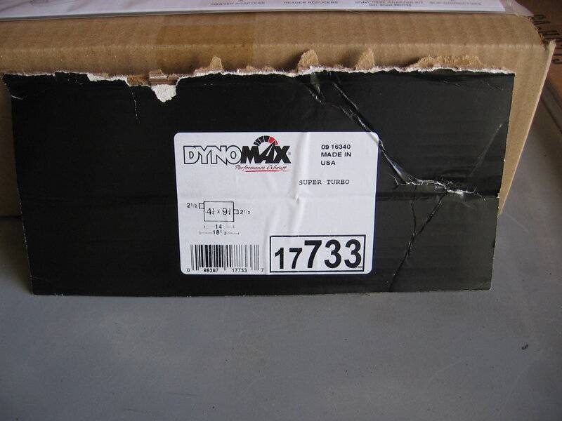

I’m looking to replace my chambered mufflers. They sound ok, but drone quite a bit at times at low rpm. About 1500-2k rpm during take off only. I want a short body muffler that won’t kill a loping cam sound and not drone under acceleration. I was thinking of this Dynomax. But, I’ve seen people comment that Dynomax’s drone quite a bit. Can anyone make a recommendation based on what I’m looking for ?https://rover.ebay.com/rover/0/0/0?mpre=https://www.ebay.com/ulk/itm/164133514518

I have the Dynomax on my Challenger and the tone is awesome - people tell me the car sounds great. But they are a bit drony between 2000 and 2800 rpm - after or before that they are OK. Borla are well worth the extra money.
