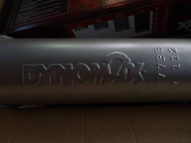

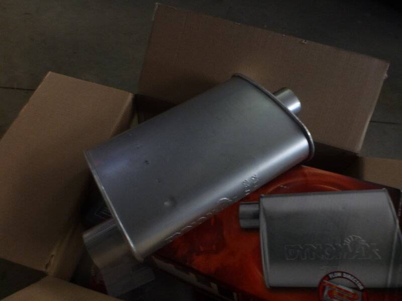

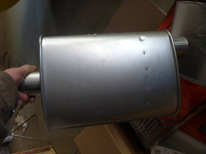

Is what I bought for the Dart off Amazon for cheap and free delivery.. These are 2.5 in and outs. Haven't got them on yet..

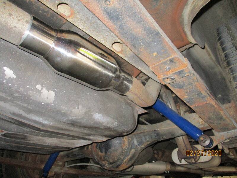

I had a similar problem when I bought my 69 Roadrunner. It has flowmasters as well and sounded great at idle but droned crazy when driving. I was looking to replace the entire exhaust because an earlier"restoration" installed a custom 2 1/2 setup that fit like crap. But then I thought to try some resonators and found some stainless models at Summit Racing. I cut the exhaust pipes along side the gas tank and spliced in the resonators. WOW. What a difference. The idle still sound great and NO DRONE when driving at ANY speed. I think the resonators were like $50 each. I great fix!!!
