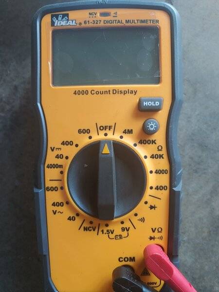

Hello I know nothing about these meters and I'm attempting to build my spark plug wires which they are MSD super conductors 8.5. Which setting do I use to get the correct reading.
If specified at 50 ohms per foot the 400 scale should test up to 8 feet, and I assume ypur longest spark plug wire is 4 feet.
Yea probably close big block number 7 & 8 depending on how I route them

Thanks I checked the ohms before I installed the metal distributor cap retainer/boot just to ensure I close to the same reading after the crimp. I feel a little better knowing I have some current going to my plugs
I think you can start on a higher scale, and as you reduce the meter scale the reading resolution will increase until the scale setting is too low.
Start on the 4M scale (4 Megaohms), and move down until you go off-scale, then go back one space.
As long as there is no voltage present you cannot do any harm that way.
Do yourself a favour, and measure the meter lead resistance first, and deduct from the readings to give the final result.
Usually the higher meg ohm setting is used to determine leakage resistance to ground as in checking for grounds of motor stator windings or field coil windings. The best test for ground resistance testing is with a "megger" or a "high-pot" test, measuring voltage to ground as meg ohm resistance. IMO....if measuring continuity, use the R x1, or the lowest ohm scale available on the device being used. The wire or conductor has inherent resistance, generally expressed as ohms/ft x the total footage of the wire. If your measurement exceeds the calculated value by more than 10%, replace the wire or conductor. Meter lead resistance will be negligible and can generally be ignored. Just my opinion of course.
