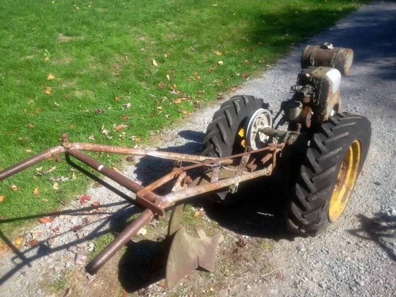

Old Waterloo boy walk behind tractor. Stripped fuel bowl bolt on a 5 HP Honda
