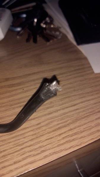

I get the thing home and tear into it and here's what I discover:
See it? A friggin HOLE, right there in the drivers' side caliper hose!
The amount of corrosion was stunning - we don't live in "salt country"...

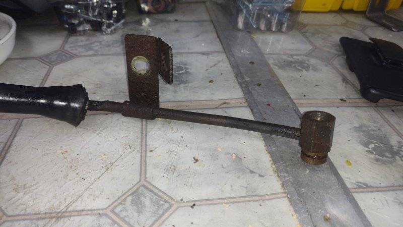

What kind of cockamamie rig is this? Metal bracketry to attach the hose to the FRAME
even before the connection to the metal lines?
The junction on these things at the frame end has a small metal line with flare coming to it
from below AND above??
Well, the "below" one didn't fight coming loose....
but the top one sure did, despite PB Blaster and repeated attempts at hold-backs.
Twisted the end right off her, I did....so I need to do something about that, too.

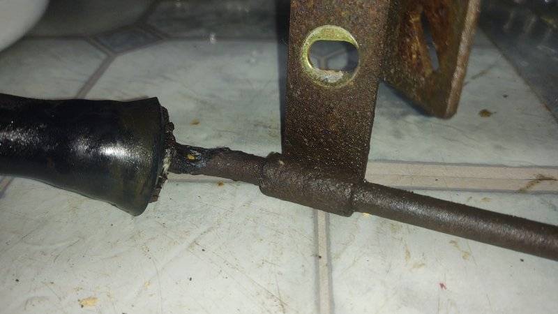

Upon further review, it appears this line/hose has been rotting inside the heavy rubber "protector" sleeve for a while now.
This thing was a damn time bomb...

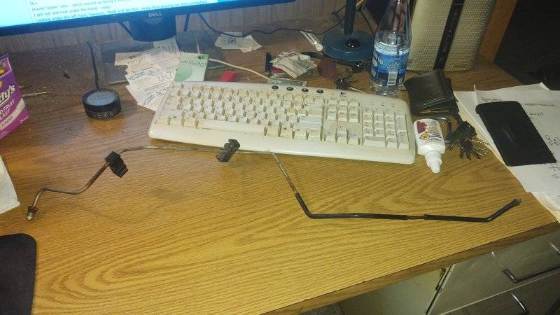

Beats me, but here's the entire bent up line off the truck now - and it's got two different
sized fittings on the ends:

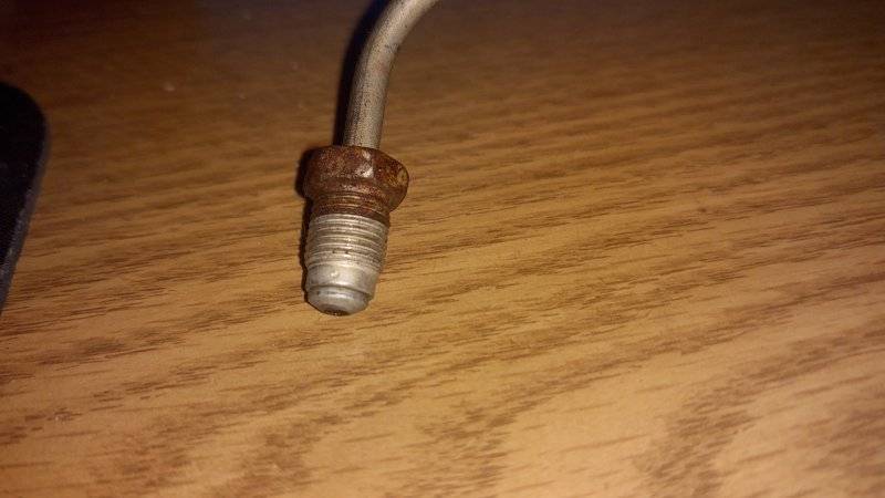

This is the end that goes directly into the rear port of the master cylinder (!).
Reckon that means only 2-wheel ABS?
....and our twisted-off end that goes into the top of the 3-way connector for the
caliper hose (I have the "nub" too, which is different than the other end fitting and
seems like it's the same size/type as the other hard line still on the truck - the one
that comes up from underneath on the caliper hose 3-way connector).
There's the whole shootin' match. If the end fittings can be reconciled,
I reckon a store-bought stick of whatever size this is will do just fine.
Still sort of confused that this line goes directly from master cylinder to
the left front caliper, though?
Maybe the right front caliper is fed off that bottom hard line that's still on
the truck?
It would pretty much have to be, I imagine...

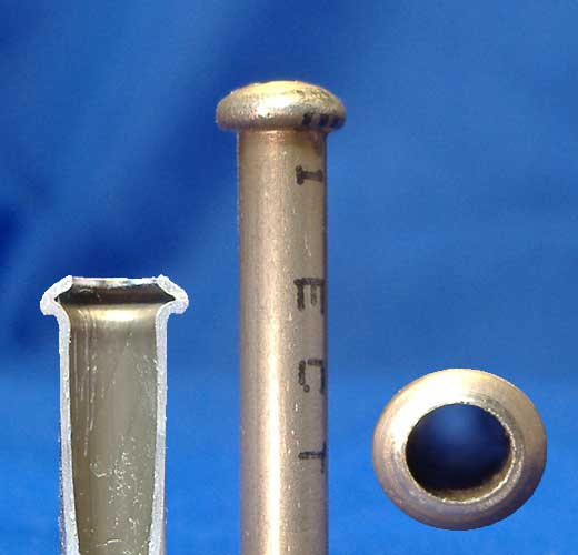

That’s a bubble flare, most people won’t have the correct tools to make that.

Bubble flare or DIN/ISO flare
