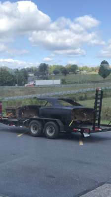

Scooped up this 68’ Charger a couple of months back and figured I should just start a thread for the car seeing that I have plenty of questions and would also like to give back to others needing info.

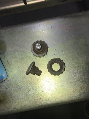

First thing is I stripped the car down to its bare shell (or what’s left of it) to see what I was working with. Fortunately after enough penetrating spray, I only broke every other bolt! Haha.
