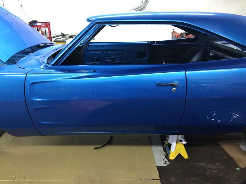

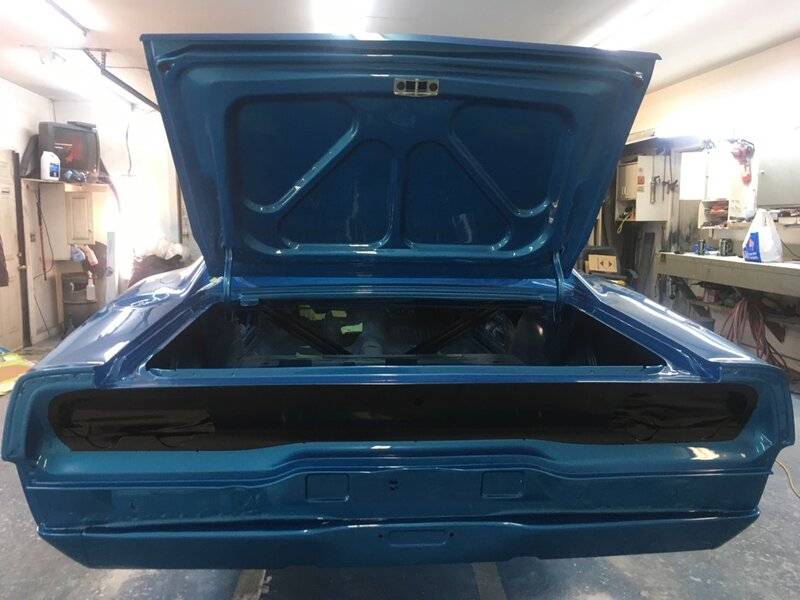

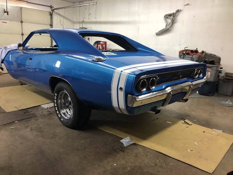

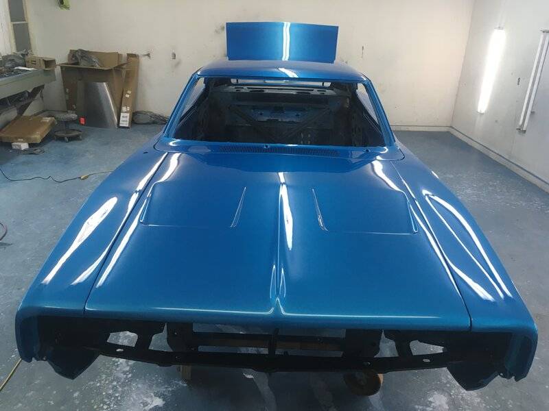

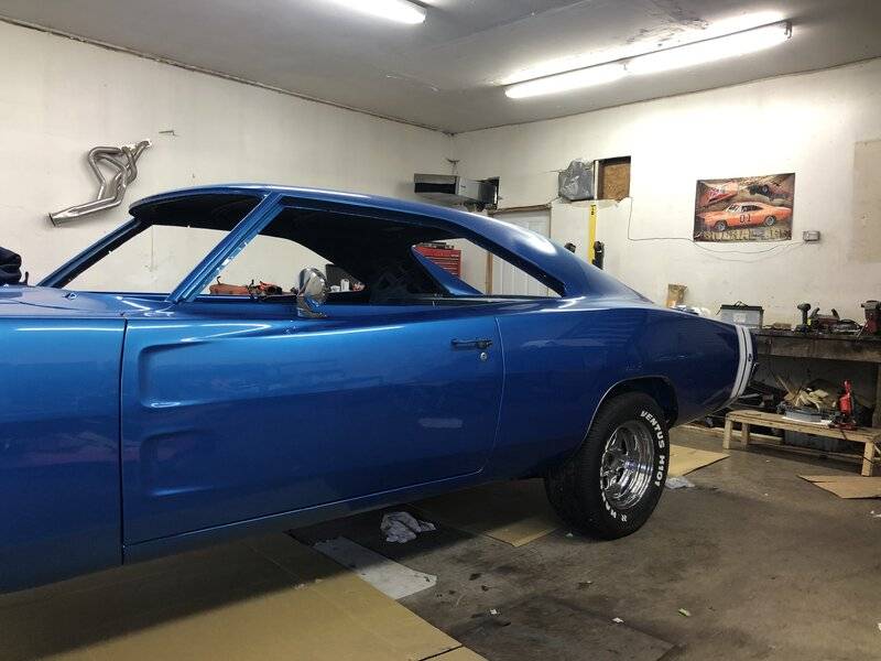

Hey Folks; just sharing some pics from my restoration of my dream car. It's been a long road but I get it back this weekend from painter and I get to put it all back together :)
absolutely beautiful color.
that has to give you a proud feeling,to see the car go from start to almost finished :)

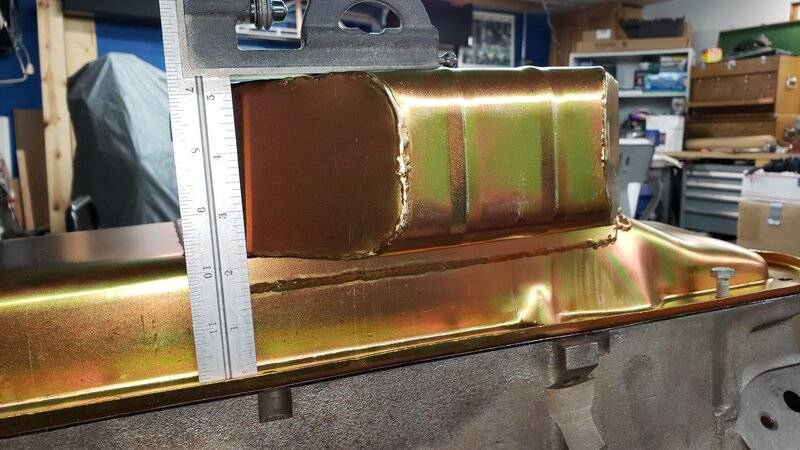

Very nice! Is that QQ1? That skid plate looks awfully tall! Is it a stock replacement height?
What type of pan are you using that you need all of that protection? Ahhhhh, now to put

Yeah I had a Milidon 7Qt pan that hung down 2 inches so I made up one to protect it.
I have a 68"X" and struggled with the oil pan dilemma until I just said, "Screw it!"
and pulled the trigger on a Milodon road race pan with an internal pickup that
I enlarged the block passage to 1/2". So, what's the paint code?

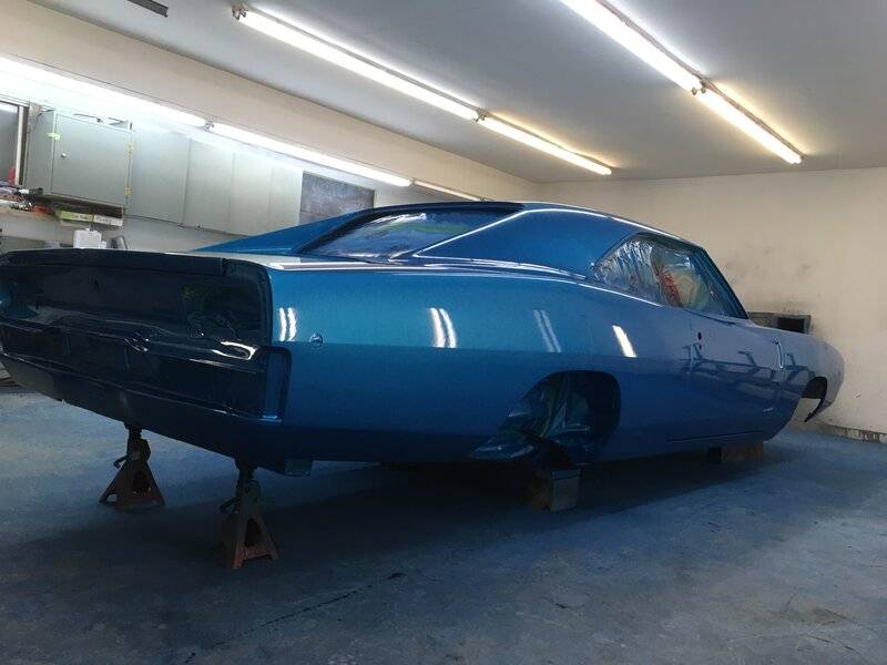

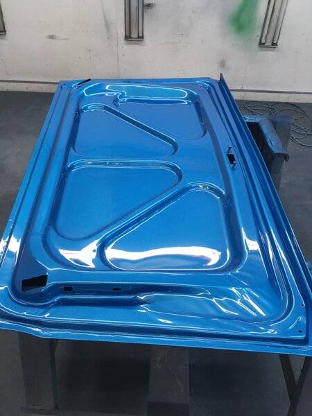

That pan looks awesome!! Hope you are using a HP pump to keep your oil up :) The color is a custom 2 stage mix for a b5 look only a lot more mica for sunshine pop, you guys have it good in the states for paint we can't get the good stuff with the hi volatiles here in Canada :D
The pan is a 35180 Milodon with a 18338 1/2" pickup. I'm also using a Molodod high pressure/Hi volume
pump with 1.200 tall rotors. Have to have oil to make HP! The paint looks very nice!
Beautiful work!:thumbsup: I'm not a blue guy but that sure looks nice on there, keep the pictures coming.
