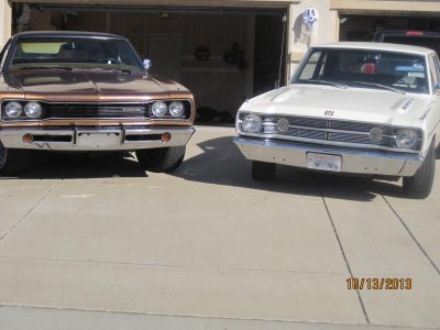

I'm a long timer lurker, 8 month member with my 69 Coronet 500. The car wasn't bought as a resto project, instead I was planning on driving and enjoying it while making periodic upgrades. The Coronet was originally a T7 Dark Bronze, 383 2V with a 727 on the column, bench with a buddy seat, saddle tan interior. In it's day a pretty pedestrian car. Somewhere along the way a 1976 440 truck motor was swapped in. The TF feels like it has stock stall and the 8.75 has a SG with 3.23's. All in all a nice cruiser to compliment my 68 Dart that has a 380 hp 360 crate motor, tremec 5 sp and 3.54 SG 8.75 rear end. In fact my wife is a confirmed Mopar gal and the Coronet was for her to drive. (I know, usually the wife drives the A body but she digs the B body).
The Coronet was a purely spontaneous E-bay purchase; Maria left me by myself for the weekend while she went to Tahoe with the girls. I told her not to leave me alone with a computer and internet connection.:toothy10:

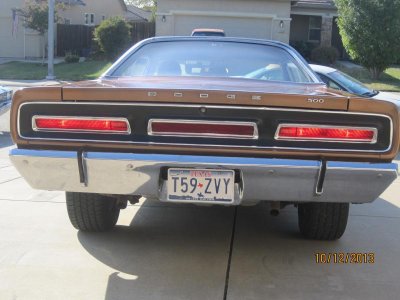

I love the 3 light tail panel on these cars! Back in the 70's growing up my aunt had one and ever since then I've wanted one.
image.jpg Oh yeah on the tail panel.
View attachment 196547 Oh yeah on the tail panel.
Hey Dennis, love that car. For those that don't know Dennis' car, its a 500+ hp 440 with a tremec 5 sp, A/C, electric cutouts. The tail panel is the view most people will see if they go up against it.

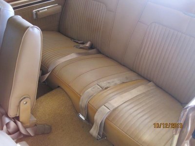

So here's more picsIMG_1154.jpg. The PO had the car for 10 years and put less than 1,000 miles on it. He had the interior redone shortly after he bought it, so it's 10 years old but it was in great shape. At the same time he had the vinyl top redone and changed colors from tan to black.

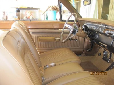

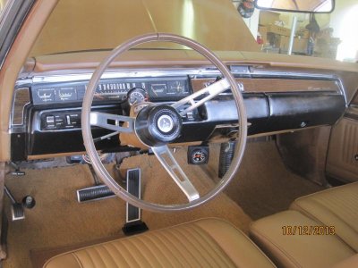

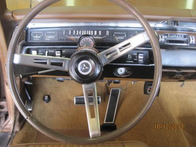

IMG_1155.jpg A saddle tan interior, and someone dyed the dash pads black. And the mini-tach has to go!

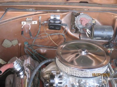

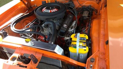

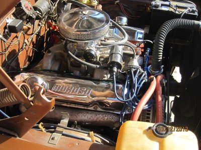

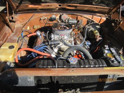

The engine is basically a stock low compression '76 440 with an Eddy Performer 440 intake and a new Eddy 650 carb. The stock log exhaust manifolds drop down to a 1 3/4" dual exhaust.
Because the intention was for this to be my wife's driver the car had to be safe and reliable. So the first thing to go was the stock point type distributor; replaced with a Pertronix III with Flame thrower coil. And yes, the ballast resistor is by-passed.

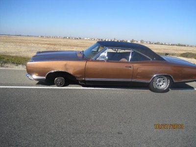

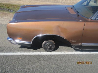

I know, I know, I'm leading up to it. So the original intent was to fix the car up to make it safe for Maria to drive. On the immediate list was converting the front drums to disc, changing out the 22" in rad for a 26" with fan clutch and shroud, replace the worn out shocks and rear springs. And then this happened while test driving after the Pertronix install:
The gory details can be found in my other thread: http://www.forbbodiesonly.com/moparforum/showthread.php?61699-Best-to-check-those-lug-nuts!
What a bummer! Thank goodness I was driving the car at the time and not Maria. And thank goodness I pulled over when I did; I was still going about 30 mph, but man, it could have been really bad. As it was it felt like I was hit with a canon ball; the front end hit the ground so hard the car bounced and my head hit the roof.
So at this point I'm thinking repair, not restoration. And let me back up - props to Hagerty insurance, they took care of me every step. The towing was free and the settlement was fair. In fact because I was going to do most of the work myself, I could have done the repair for less than the claim. In fact, later on more damage was discovered and Hagerty stepped up again.

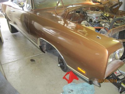

So now I have a crumpled fender, dented rocker panel, damage to the upper cowl area, etc. etc. To put thins in perspective: the Dart was built when I bought it, and except for some minor work, all I had to do was drive it. Prior to the Dart I had owned a '69 Charger R/T SE, from 1979 to 1990. Marriage, kids, mortgages, etc. got in the way and I sold it, and like everyone else, regret it to this day. But the point is I hadn't worked on a Mopar in over 20 years. I had basic hand tools, mostly metric from working on modern cars, so I was way out of touch. Fortunately I had been subscribing to Mopar Action and Mopar Muscle for a few years so at least I was plugged in to the vendors that supported Mopars, and of course FBBO and FABO. Thank God for you guys out there or I would have been lost.

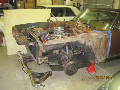

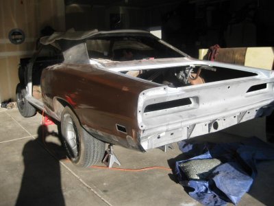

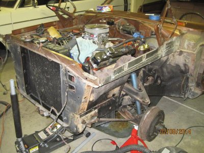

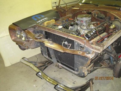

Regardless, I had zero experience with body work. But I still had the 69 FSM from 25 years ago so armed with the book, lots learned from everyone on FBBO, I dug in and removed the grille, hood and front fender. Not bad!

That's a good looking Coronet and I had never noticed that no one repops fenders for the 69 Coronet. From the pics it looks like your fender can be worked back into shape with a little time and effort. Good luck,

Thanks BB. I thought the same thing, but I was told different by several people and not having the body skills I went ahead and got the front clip. It turns out the replacement fender needs massaging before going on the car so it's a wash. Eventually I will sell off the excess parts and recoup some of the investment.

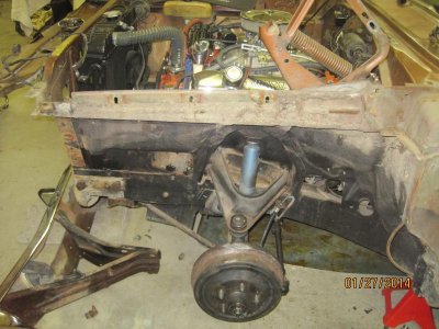

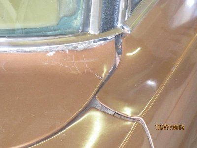

So after taking off the LH fender it was apparent there was some damage to the upper cowl where it meets the A pillar. RGAZ noticed it in the Lost Lug Nut thread.

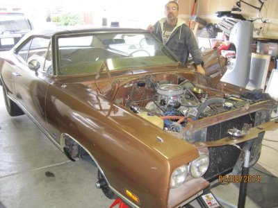

IMG_1171.jpg On the upper cowl there was bubbling under the paint by the vents and around the windshield moulding. This is starting to look serious. At that point, still in repair mode, I figure it's gonna be hard to match the RH fender and cowl anyway, so off comes the other fender to see what's going on.

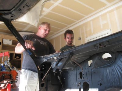

Say 'Hi" to Mike; you can tell he's wondering what he got himself into!

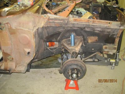

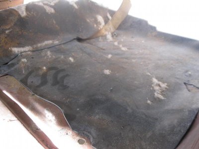

Backing up to the beginning again, the Coronet came without a heater box installed although a brand new one still in the box was in the trunk. During the fender removal I took a flashlight and looked up underneath the dash on the passenger's side - dreaded rust on the inside firewall. I took off the kick panel and found more rust. The rust covered almost the entire area from the RH A pillar to the middle of the firewall. :BangHead: It's feeling like a rescue mission now.
IMG_1171.jpg IMG_1256.jpg IMG_1255.jpg IMG_1233.jpg IMG_1229.jpg IMG_1257.jpg
Good luck with your fix / restoration! You have 2 beautiful cars
The worm turns
So at this point the front of the car is disassembled and the windshield is out. This marked the turning point in the project. As I posted before, under the dash was rust infested and on top of the dash where it meets the glass and also the edge of the dash pad had rust spots bubbling up. With the windshield out it was easy to see against the tan paint. Also, the trunk had rust issues too (go figure). The PO was up front about it and posted pix on E-bay so it wasn't a surprise. The PO had applied POR-15 in places and also laid down seam sealer.
Mike and I took stock of where we were. Every time I pulled back another layer from the onion, I was finding more rust. And I figured if we patch up the front and re-paint; then the engine compartment will look like crap when the hood's opened. Can't have that. So early one March morning I arrived at the WWOFBBOMD (What Would Other FBBO Member's Do) moment. I must restore!
