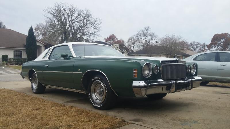

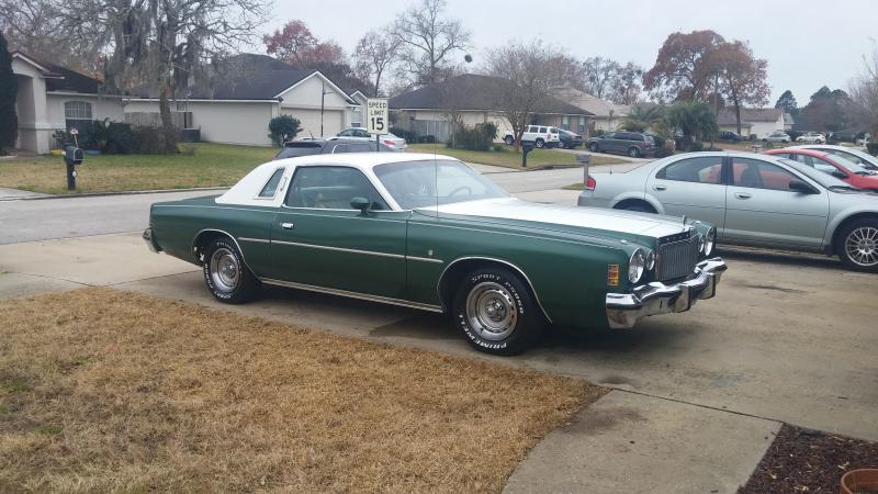

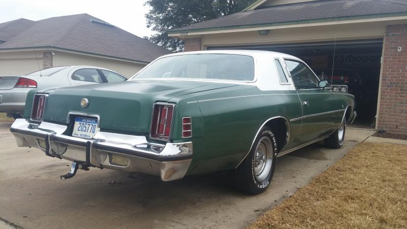

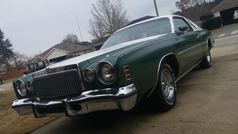

Since I've been looking around, and asking some questions (more to come) figured I'd post a thread on my car. I've had her for a year last month now, and put over 8000 miles on her so far.
She has a decent running 400. Was an Orlando car its whole life till I brought it a little north to Jacksonville. I've done a good bit of work on her so far. Starting to work on the interior. The FL sun has not been kind to it.

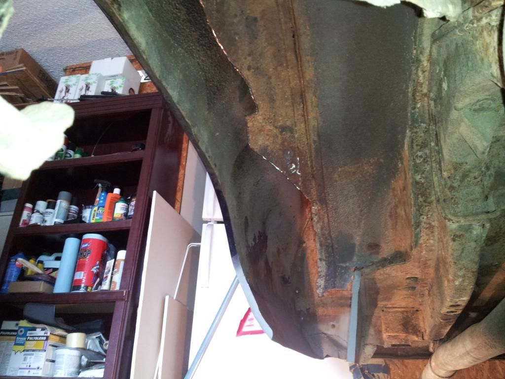

First order of business was to address the trunk floor. The underside is beautifull, but moisture building underneath the carpet, and insulation took its toll.

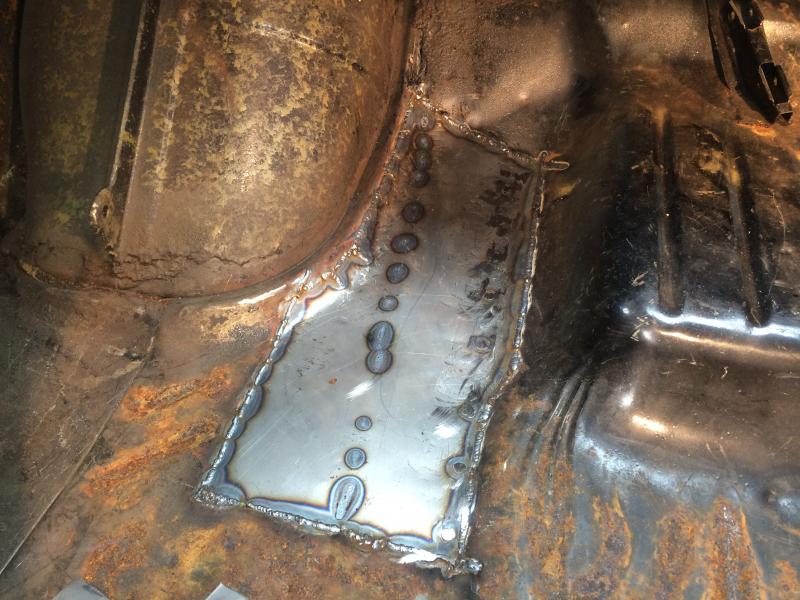

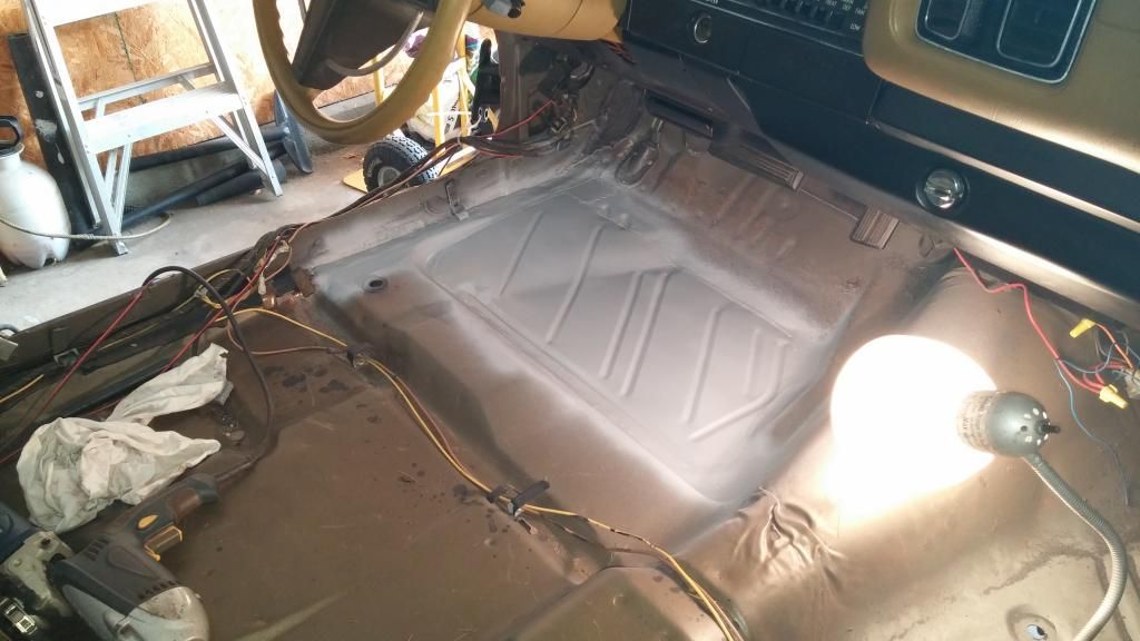

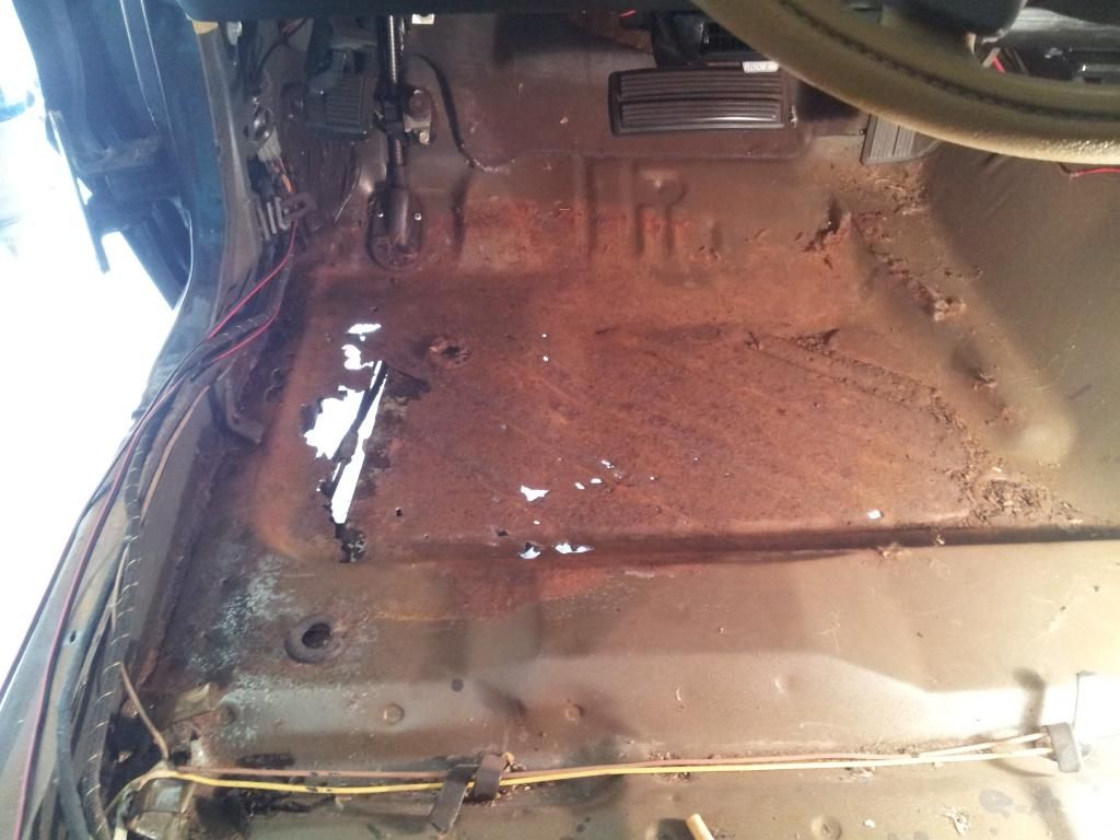

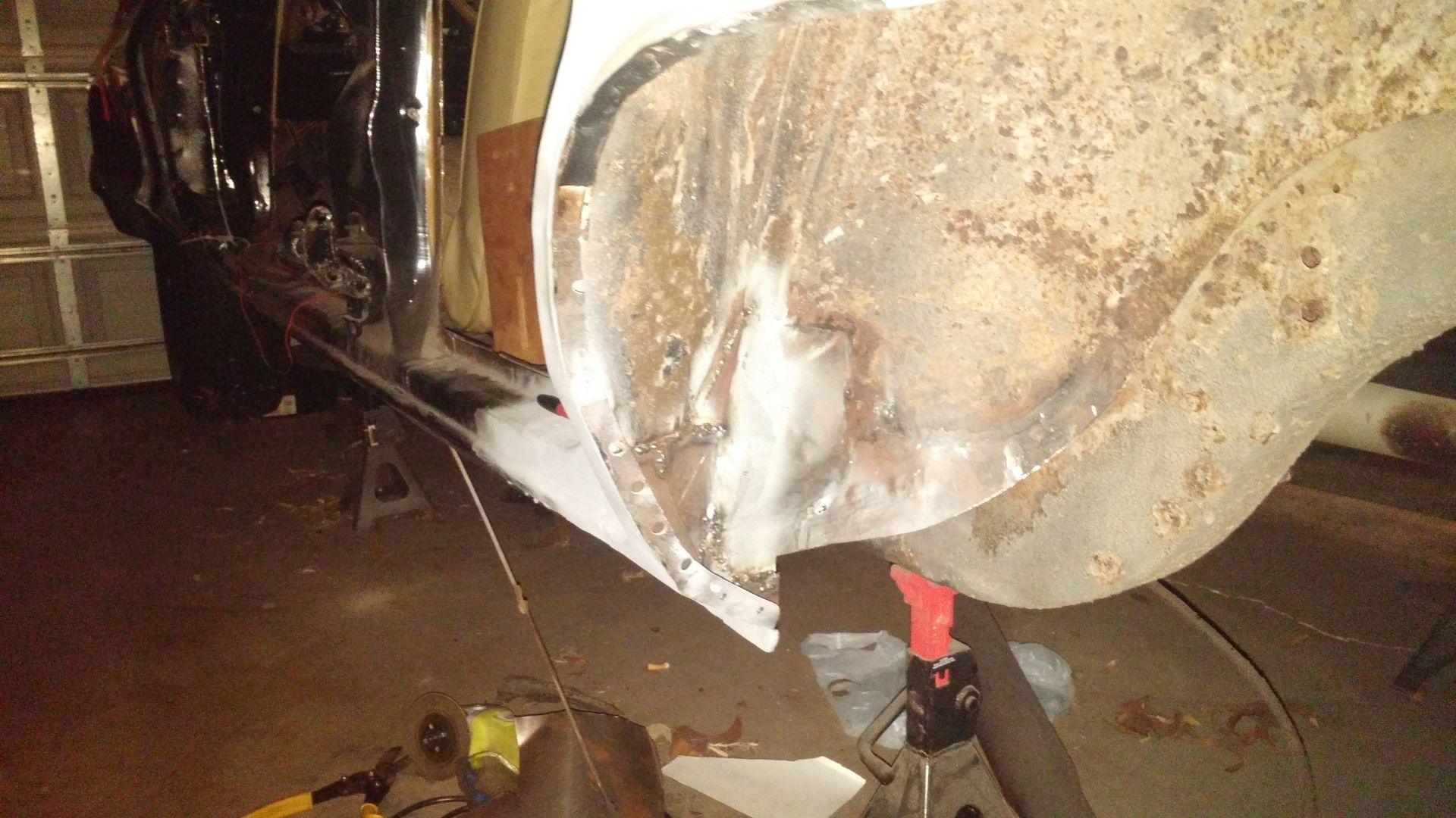

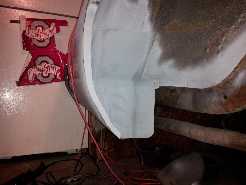

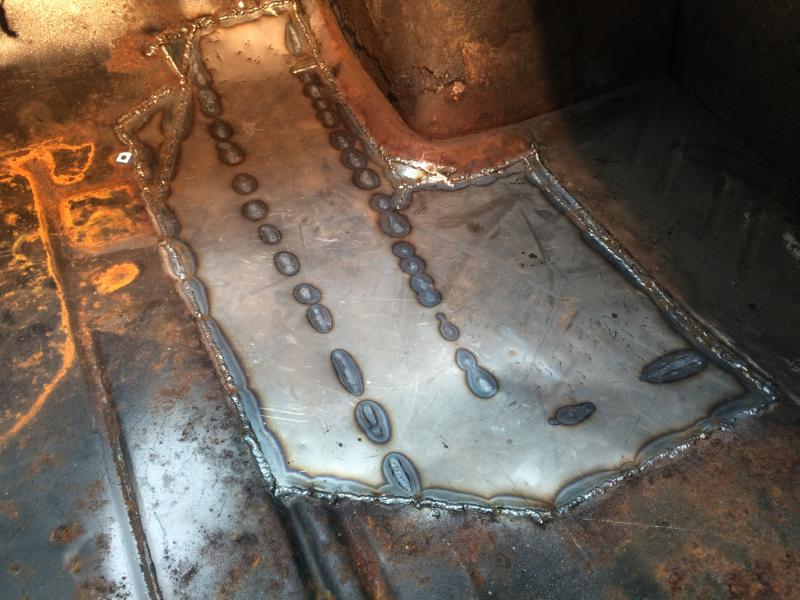

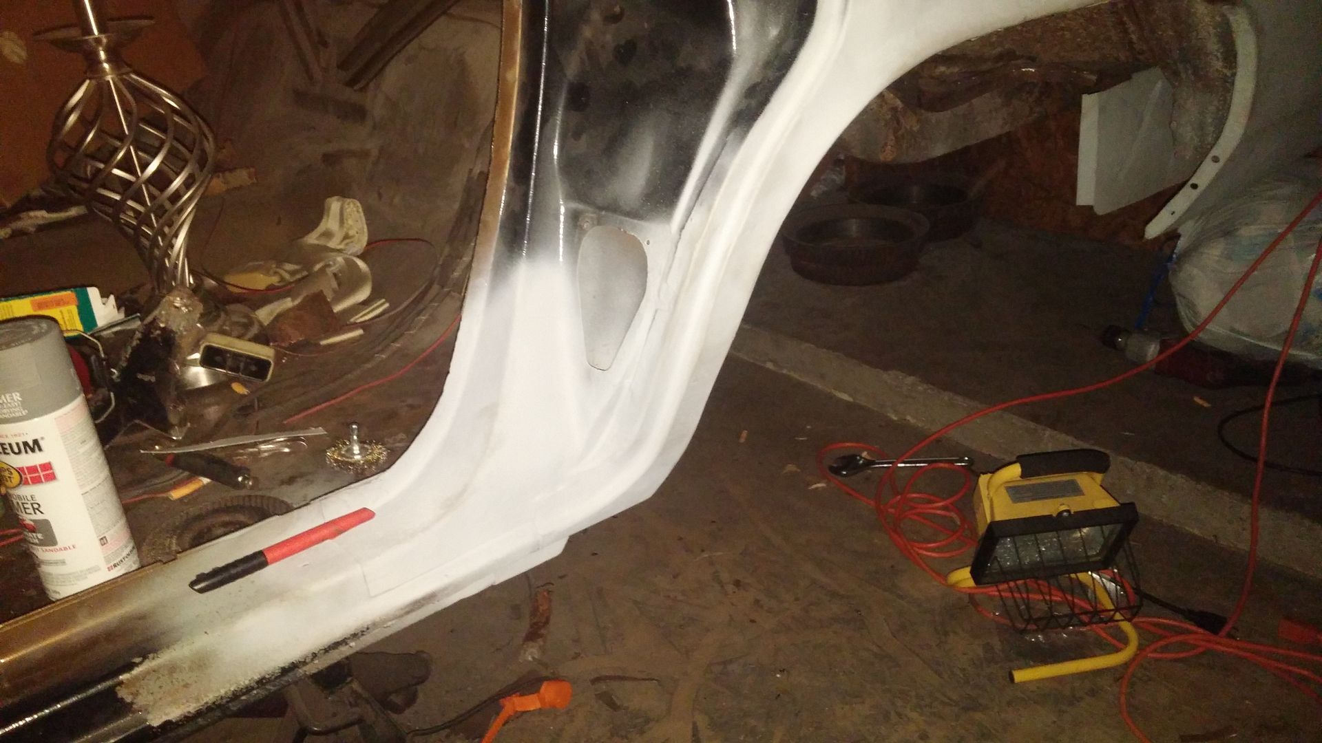

I ordered a new carpet kit to replace the NASTY original carpet. But of course what did I find after ripping the old out? Fabbed up a new section of floor plan for the driver side. I ended up cleaning and fiberglassing the passenger side. A lot of curves, and bends I would of had a hard time replicating. Is still pretty solid. Good enough for a daily driver.

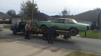

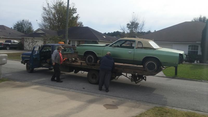

Here's where I am now... Last weekend I picked up a '75 charger parts car out of Tampa, that I had posted in another thread. I pulled everything I needed/wanted from it. Mostly interior pieces.
Was a center console car to boot!

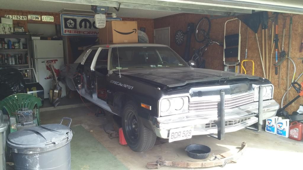

The Monaco in the garage is my baby. Was my first real running, and driving Mopar. She's the Bluesmobile. She's been in the garage the last 2 years getting a TON of metal done to her. Also have a rebuilt 440 waiting to go in after the metal work.

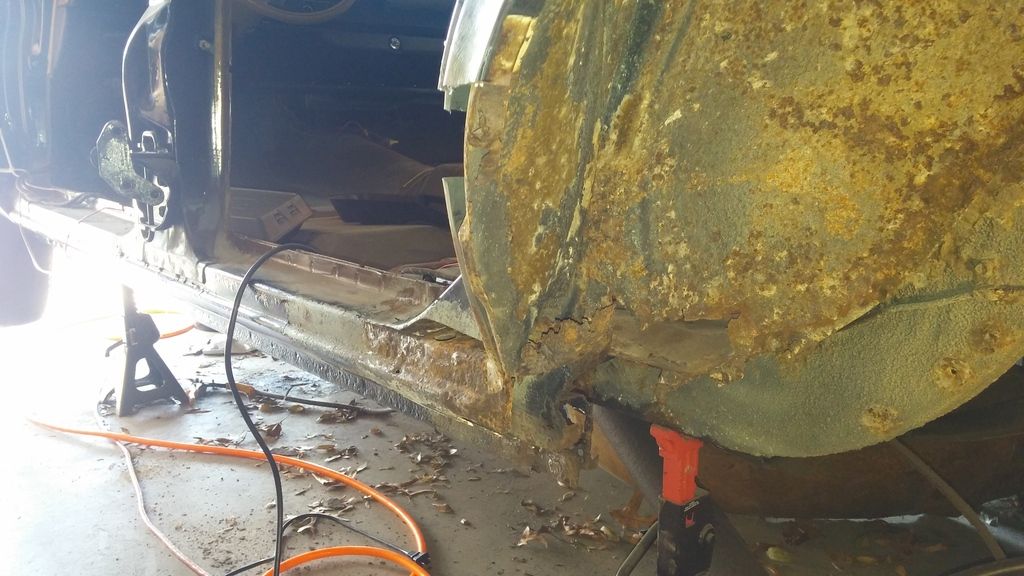

got mine in a trade and only cancer is on the trunk pan exactly where yours is just worse and spread to my rear outside rocker panel. Ill post some pics but i mainly need a grill and different seats as the bench needs redone and would love buckets and a center console.

Not too much left. The old girl was hauled off a few days after I brought her home.
The guy I got it from kept the header panel, front bumper, and a couple other things. Only 2 great body panels left were tue drivers door, and the hood. Im keeping the interior for my car. I've got a few pieces of trim available, mechanical parts, and small stuff.

Very impressed with the level of restoration. Keep posting great pictures. Just replace section of my dodge magnum trunk floor. IMG_1661[1].jpgIMG_1662[1].jpg

Man that looks familiar!! lol looks good! I didn't go too crazy on mine. Welded the patches in, made sure all the pin holes were filled, and grinded the welds down a bit. I didn't grind them 100% flush. Just enough to make sure there were no holes.
