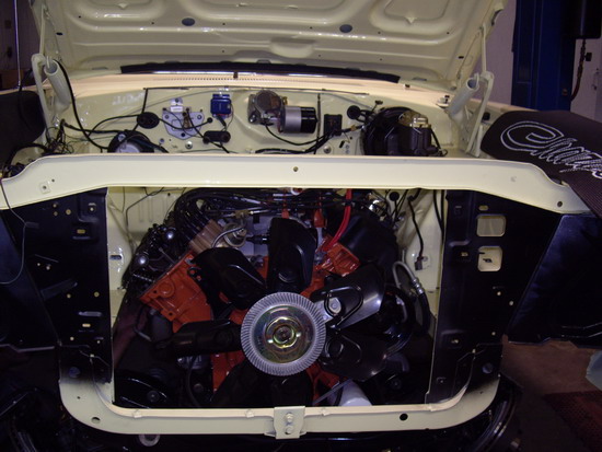

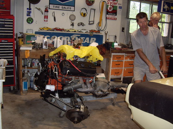

I finally got to install the hemi, from underneath. It took just over an hour. I'm stoked! Gerry

Ma mopar didn't have a lot of room to spare, but it was enough. The right valve cover was removed before we started. We had to make sure the engine was lined up so that the right exhaust rocker on the no. 2 cyl. was forward of the shock tower on the inner fender. We also took out the trans dipstick/tube and the engine dipstick.
