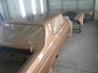

Got some more work done on the engine yesterday.
Having issues with pics for some reason.....sorry
Thanks, I'm pretty happy. I was a little nervous about going with coppertone but I'm glad I did
First of all two thumbs up on the color choice! :icon_thumright::icon_thumright:

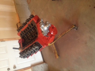

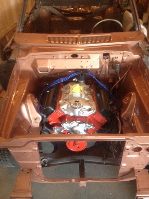

Engine in...and I'm still alive
Well, after some issues with the pilot bushing that I needed the machine shops help with, I was able to get the transmission all assembled and attached to the motor. Once I got that done, I thought let's just go for it and dropped the engine in all by myself. Probably not the best decision, but it is in and I still have all my fingers and toes and all vital organs.
Awesome color, that motor looks good in there. You've done your dad proud!
Keep up the good work!
X 2 Looks great sitting in there, Its a cool thing your doing and the beast is going to look meaner now then ever! Good luck to the finish line! :)

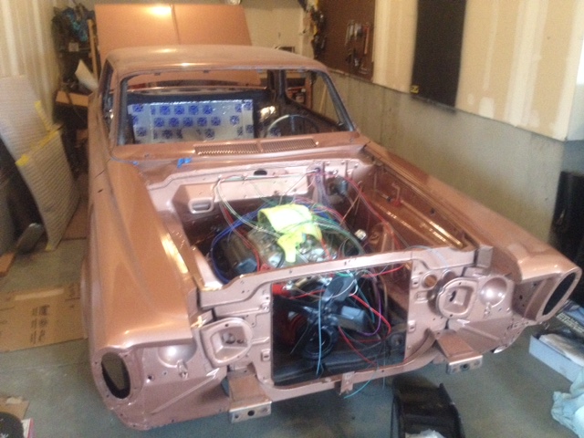

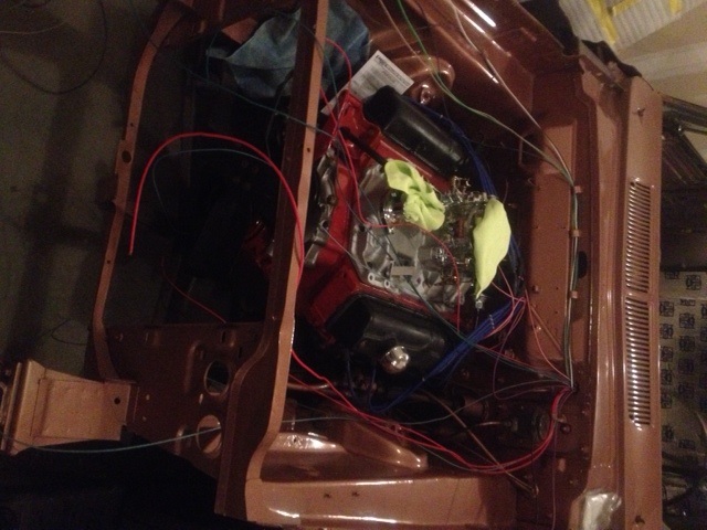

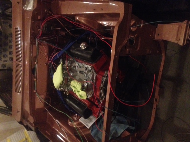

Well guys, project is still moving along, a bit slower though. I about have the engine ready to go; just need to connect fuel lines and belts and hoses and stuff. I am just about finished with the fatmat insulation, just need to add some to the roof. I've started running some wires and having the EZ wire harness spread out a bit with wires ran to the front and back it doesn't seem quite as daunting. Anybody know why my pics are always sideways???

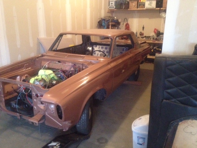

Got the fenders on. Starting to look like a car. Now I can get moving on wiring. I have all the wires run to about where they go just need to start making connections.
