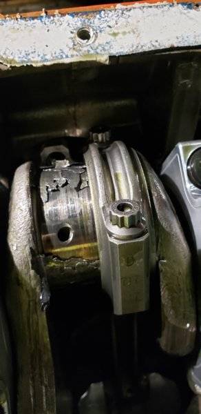

My quest for another championship has now ended.
Entering Saturday's race I was 20 points out in second place while only running in half of the races this year.
I made my first timeshot and felt like the pass was a little sluggish. Air wasn't great but ran a 9.88 at only 134. No indication of any problems though.

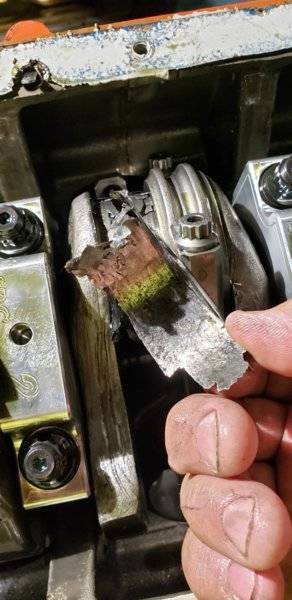

Went up for my second timeshot, did my burnout and the car stalled. I started it back up and heard a knocking so I shut it right down. I had it towed back to the pits and loaded it up.

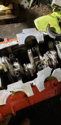

Got home, pulled the motor and found this.
YUK!!!!!!

WTH. How much timing? Aluminum mains don’t typically fail, So I’d wonder if something failed that allowed the timing to advance.. There has to be a reason for it to split the mains...

I've never seen main caps fail like that! Very odd that it appears they all fractured the same way. 440'
Mercy, what carnage. What's that from, starvation?
Also really curious to know what happened.

Are any of the main bulkheads cracked? I've had them crack pulling the front 2 bulkheads completely out of the block. The aluminum caps and bearings still looked new. Whose caps are those? I wonder if when it cracked the caps the mains were loose enough to starve the rods? Other rod bearings will tell the tail.
