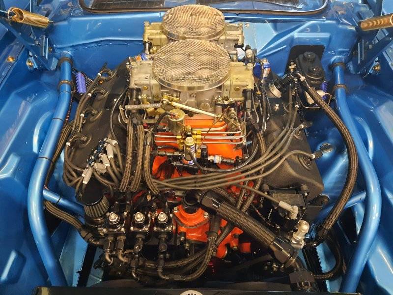

Have you done it on your '70?
Nice car BTW.
Yes, I have done it hundreds of times on so many cars of mine and my buddies over the years.
Even install and remove my Hemi by myself in my Challenger whenever needed. So far so good with no scratches.
