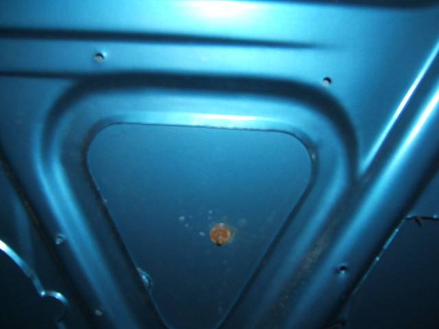

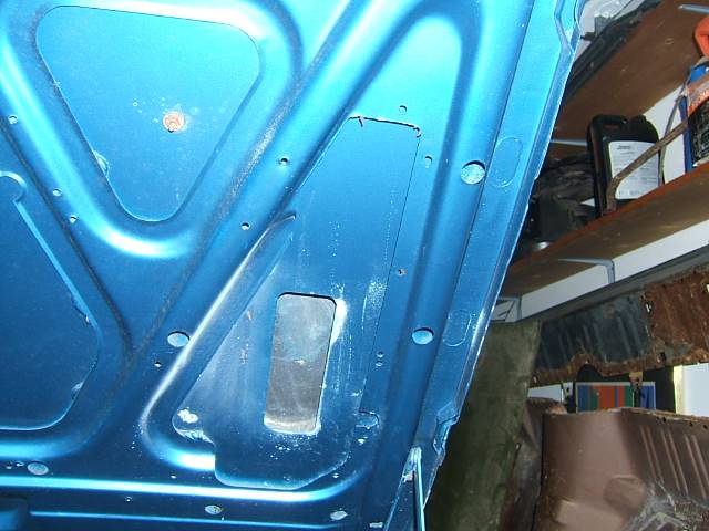

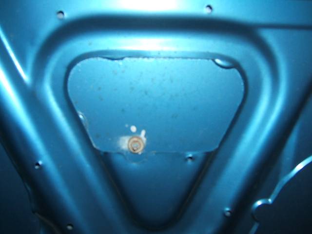

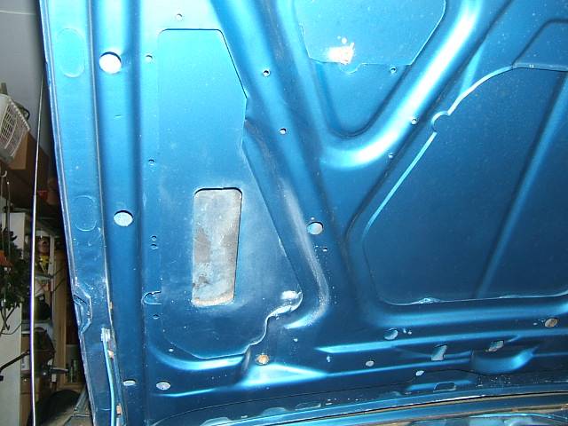

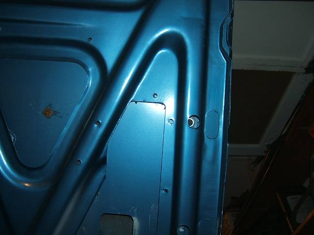

I have to media blast and paint the hood on my 69 Coronet so I was considering converting to a Ramcharger setup. After getting the mounting and spacing specs for the scoops (from another thread on this forum) I was mocking it up and noticed some of the mounting studs went into underhood bracing. Is the factory N96 style hood different underneath from a flat hood? And if so can the flat hood still be used, with mods? I've looked at a lot of Ramcharger pictures but if someone has a picture of a N96 hood without the fresh air installed could you post the picture?
Thanks
naked 69 coronet n96 hood
Thanks Flypaper, these pics are just what I'm looking for. So it looks like some of the hood scoop rivets go through the underhood bracing.
