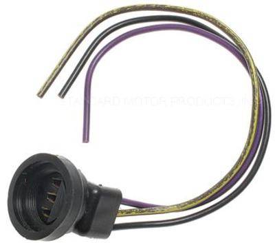

If you want a clean installation, get the plug ( available at several places on $15-20 rate ) and use the central pin wire ( brown with yellow trace ) straight to the Starter relay ground prong and you are done.
The outer wires are for back up lamps, but since your 68 gets these straight to the shifter you won't use it. Unless you want to "upgrade it".
If you want, just will need to extend your shifter switch wires up to the NSS plug and done. One is power from fuse box ACC side, the other one is the output to backup lamps.
Some pigtails use dual black wires one of them traced white for outer wires ( tipically used up to 74 ) some other with a black and a violet wires ( tipically from 75 ), but they are the same deal.
Solid black use to be used from the ACC source, and the traced wire (violet on laters ) the power to backup lamps, but it will work the same if reversed.

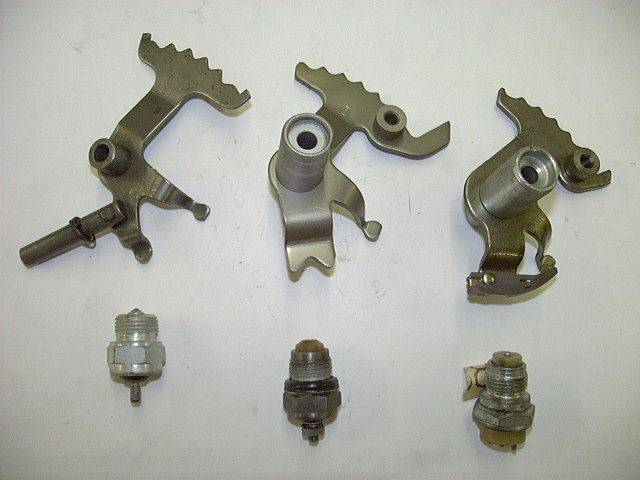

Interesting that the single pole worked in the 75, 727. The detent of the combs are different. The 3 pole switch along with the pigtail that Nacho-RT74 pictured is the correct setup for you 75 model.
The center parts are for 66-68, the parts on the right are for 69 & up.
