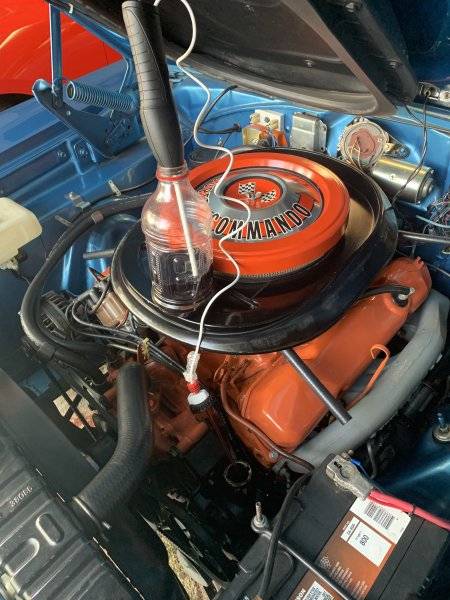

Wanted a clean way of changing PS fluid, cleaned up this battery powered weed killer sprayer and emptied the pump, added more fluid and cycled lock to lock a a couple times, refilled
Worked pretty cool
Pretty cool idea! I was just using one of those at work to spray weeds. I was going to throw it out,I will hang onto it for this type of occasion!
As the old saying goes hotroders were and are the first recyclers
