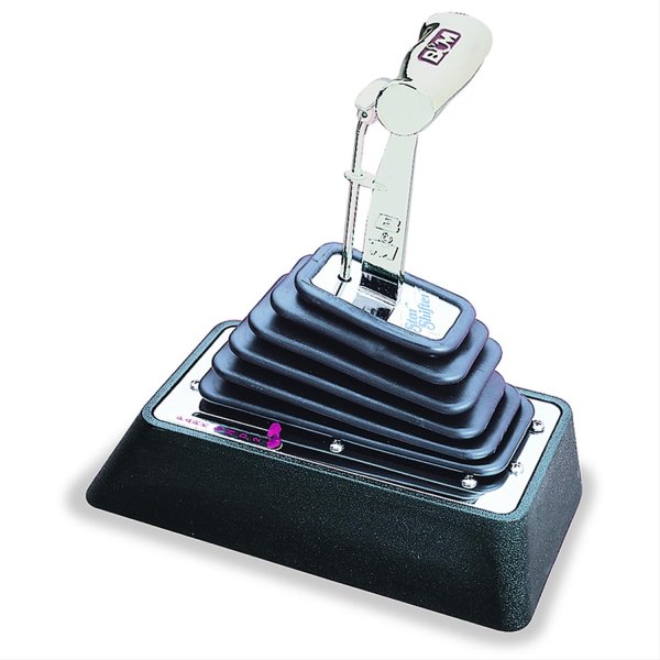

Your 1965 Coronet would originally have had a cable-shifted transmission. Both the transmissions you have are linkage shifted, so you will have to come up with another way to operate it, than what is currently in your car.
Thanks guys for the info. I guess I need to tear into the donor to see what it has internally and go from there. I have a shifter I picked up at a swap meet last winter. Guy had everything to use it on my transmission. Cable, bracket for trans and shift lever for trans all for $125
