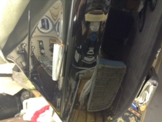

Can someone with a 68 GTX/RR/Satellite provide a closeup pic of the fender bullets on mounted on top of their fenders. I don't remember which way the turn signals canted and a quick pic and which side of the car taken will tell me all I need to know. The lights/bullets are side specific.

No pics with me but seems to me the side with a little bigger edge goes toward the inside and the side with less edge goes toward the outside of the fender. Clear as mud? Going off memory so my info is worth what you paid....
Hello. They really only go one way. This is the driver side. The tricky part is the clamp underneath. If the clamp is turned the wrong way when you clamp it the turn signal will cant inwards. Just turn the clamp around. Hope this helps.

Hey Dave thx very much!! Just what I was needing. Looks like that bullet is on the driver side. I can see how the mine need to be positioned. Very much appreciated.

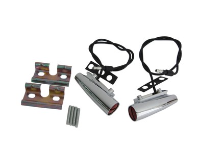

here's the complete setup minus the nuts. the one on the right is for driver side, and the one on the left is pass. side. don't forget the body gasket!252-69__85116.1418351077.386.513.jpg
Thx 69! I have a good impression of the fit now. I appreciate the help!!
