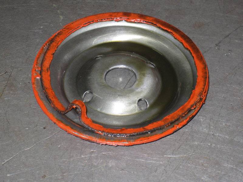

A follow up note: I found a gasket in my stash so I put a thin layer of silicone sealant on both sides and installed it per the directions on the tube (install while silicone is wet, hand tighten, in an hour torque to specs). This is the result. The correct 70522 Felpro gasket came in Monday and it seems to have corrected my leak. I used nothing on it-all was dry and clean. That pipe nipple torque spec is:45 Ft. Lbs.
