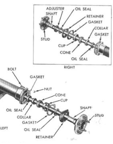

If so, then besides unbolting the driveshaft from the rear end yoke ("butterfly connector"), you also need to remove the axles on both sides too, THEN the center section will just pull forward/out. Each axle is held in by 5 nuts & a collar (passenger side is adjustable for axle play side-to-side). You can just remove the drums & take those nuts off without removing the brakes (just rotate the axles...there's one big hole you can put a socket through).

A real 67 R/T with a 4 speed would be a Dana 60 from the factory. (Yours has probably been changed.) On a dana, the diff cover just unbolts from the rear if you just need to change the gasket. Sound like you have an 8-3/4" Chrysler rear if you have to remove the differential from the axle housing to change the gasket. It unbolts and comes out from the front of the housing. Yes, you will probably have to take off the brakes so you can remove the 5 bolts on each side to let the axles come out first. Be very careful that you do not loose, or let fall out, the spacer that is in the center to keep the axle shafts separated. It is a small part that will fall out if the differential is tilted up on it's side. You will also need to adjust the end play on your axles when re-assembling it. The adjuster should be on the passenger side axle retainer. Make sure to use the little hook bracket on one of the studs to make sure the adjuster does not loosen while in use. There are gaskets on the retainers that will probably need to be replaced also when doing this.

It will be a good time to pack the wheel bearings if you do find that you have the tapered axle bearings. My stock axle flanges have access holes to remove the retainer nuts.

The retainer flanges may hang up on the studs if they cock while trying to remove the axles. I've never had to but some people have gone as far as driving the studs back.
If you are removing the axle from the housing, there are oil seals on either end in the tubes you don't want to/care to damage. (Unless you are replacing them that is)
