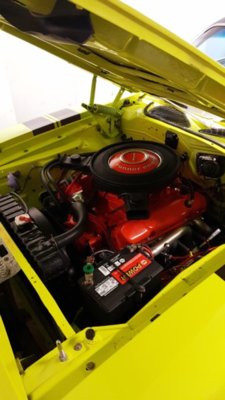

Okay, ive been working on a 440 for a while. 2 plane weiand with 750 street demon. Put a whiplash stick in it, im at 25 degrees / 12hg initial and 37/8 tot (mayby a bit high), closed chamberd 452 heads 79cc heads with newly grind valves. New crosshatch in cylinder bore and new piston rings.

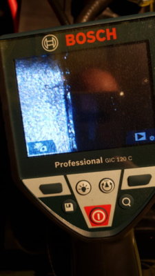

But the smoke is really white? Well i could take the camera and go down manifold and see if i the seal is clear or not. Guess ill get some more time on it and watch the plugs for a while.. Need to find the tuneing aswell, dont feel like the power is where it should be atm

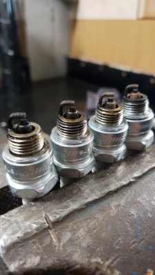

Pulled the plugs on passenger side, from the right, 2 - 4 - 6 - 8. Could it be oil thats get in? Wouldnt the smoke darker if that was the case?
#8 seems greasy indeed, while #2 is clean of deposits...
Maybe would check around #8 cylinder first if this is sucking oil at the intake gasket/valley pan?

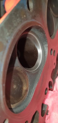

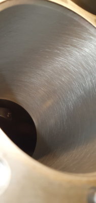

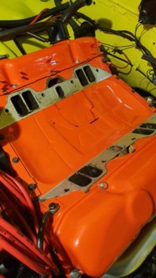

I have no gaskets on either side of the valleypan and the heads have been milled alot. So maybe the angle between the two is more off then i can see. Should i try get a gasket in there and not only black RTV.
Picture 1.
Leftside is the intake, the middle is the RTV beam and the gasket against the topside. Very hard to see on picture doe.

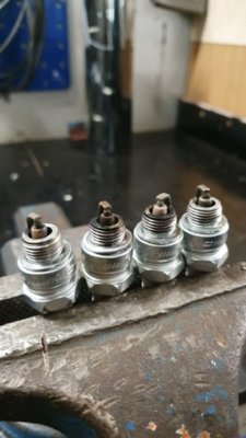

Plugs on driver side, from right 7 - 5 - 3 - 1
This side do not put out any smoke.

from the photos i'd say sucking oil from the bottom of the intake. usually you can see an oil wash across the rim of the plug. the detergent in oil can create a spot on the rim that will wipe clean with your finger and that spot will line up with the intake valve. test fit the intake with the gasket surfaces clean, and no gasket, to see if it will lay flat. if not then you've got some juggling to do.
Ok, well i measured the gap between the head and intake with a feeler gauge before i mounted it and the gap was smaller then the actuall valleypan itself but that beeing said there was a gap, so maybe thats the problem?
If there is a gap, even with a gasket/valley pan there will always remain a gap.
A good coat of quality sealant would sort it out if the gap is not too big.
Extreme deviations, caused when a lot of material has been skimmed from head and/or block, require the intake manifold to be machined, but this also could cause the ports not to line up properly anymore as the manifold sits lower then before.
Then the manifold also requires to be ported to make sure it lines up with the cylinder heads.
Looks like they machined intake aswell and the valleypan looks to be sealed right to the heads cant see or feel any gaps between valley and the head, took a thin cuting blade and couldnt get it in there seems like the rtv does its job. But its alot of oil in area, possible the valve seals are bad?
