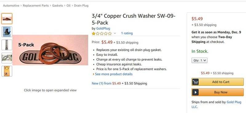

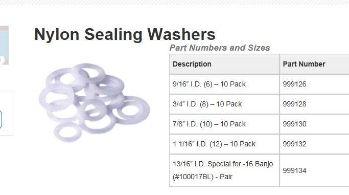

What about these, you'll need to see if these are the right size. The part number in picture, Amazon is where these are. I used nylon gaskets on my crossram.
I'm sure you know the plugs are actually differential plugs, and I'm using O rings on mine. cheap and replaceable. ruffcut
