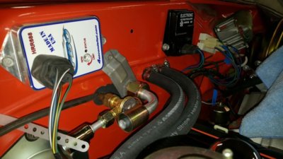

FBO ignition systems. I've had mine on since 2012 absolutely zero issues. He curves them for your build, you just tell him what you've got and he does the rest. Car starts right away every time and no big *** ugly red boxes in the engine bay. Distributor looks just like a stock one.

Firecore makes a good distributor, fully adjustable timing curve and such. 3 years of performance street duty in a hot climate and still going. Not super expensive and works with the stock stuff. Fits my RPM heads and bigass aluminum covers fine. And here I was just about to replace it because I thought it went bad, turns out my good USA-made chrome Mopar ECU had enough after 2 years of service...FBO box works better than any of the different color mopar units ever did, for me at least...
