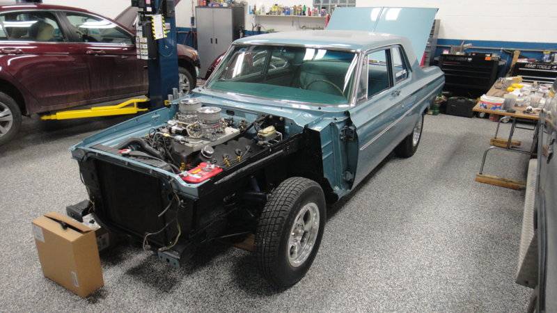

Just my 2 cents. Rust-oleum #248914 Truck Bed Coating spray cans. 15 oz can.It will take about 4-6 cans. Did my 65 and a 64 Dart. The Dart I even did the inside floors instead of carpet ( was mostly used as a race car) Worked for me nice and thin and holds up great. Just a thought.
Thanks Darter6. Do you have any pics. What type of finish was it? And can it be done without spray cans?
I think they have brush on too. I don't have any good photos.
I was just doing a quickey on the Dart.Maybe get a can and do a test for yourself.
The Dart was more of a rat rod theme. Again just a thought.
Inner fenders on the 65 is the best shot I have
Nice work there. Thanks for the pics.

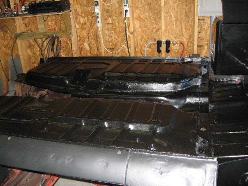

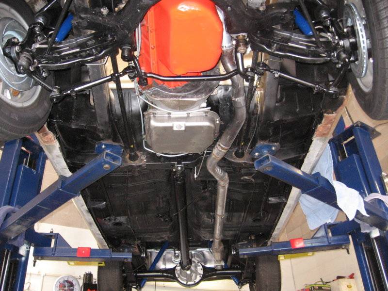

I use Eastwood Chassis Black Satin over Eastwood Epoxy primer. Here is an example car (not mopar). The coating becomes very hard and chip resistant.
