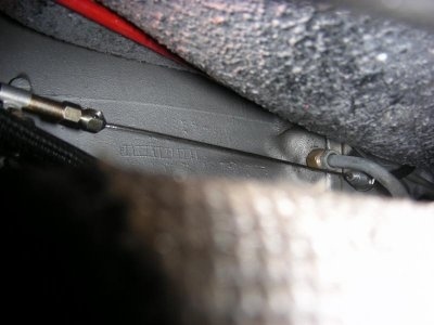

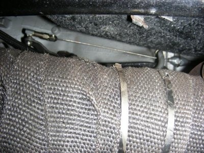

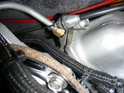

Here's a few pics from the one I had, the bracket that attached to the tail housing is close to the floor but wasn't much trouble to get fitted up.
