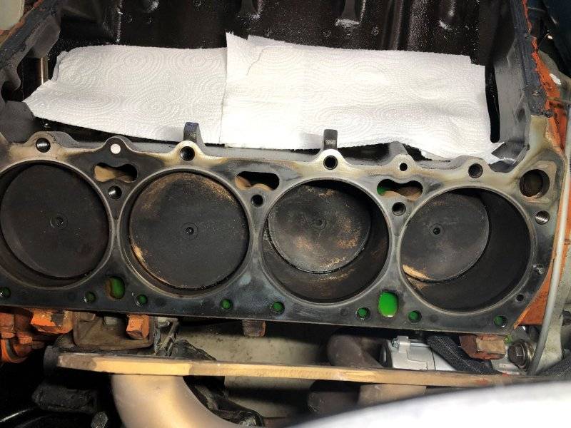

I searched and found many threads that suggest head gaskets on RB engines don't often fail, but since I received an oil analysis that shows a slight amount of coolant in the oil, I pulled the heads. Head gaskets and heads look fine. I don't see any obvious cracks in the block, but I'm guessing a cracked block is be difficult to detect.
The car was running and driving normal, no white smoke, but there is oil residue in the coolant overflow tank, which was not there before. I only drove the car ~100 miles in the last month after being parked for a year. The only thing I noticed is the #8 piston was partially clean on the top surface. I'm guessing this points to a problem in cylinder 8. Any recommendations about what to do next are appreciated.

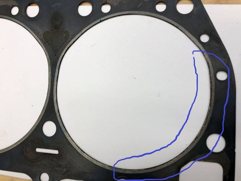

The leak in on #8 cyl. You will notice that there is a lack of gasket impression on the block above the cylinder and coolant is entering the cylinder from the upper coolant hole between cyl 6 & 8. When the engine is at temp, the gasket seals, but as the engine cools, the gasket and head contracts creating a path for the coolant to enter the cylinder. The block should be squared, and heads could use a surfacing also. Another thing I see is that it looks like the engine has overheated (crushing the gasket). it also looks like the top row of head bolts on the driver side were loose due to the lack of a gasket impression not to mention the bolts were loose around cylinder 8, likely contributing to the problem.
@69Bee - Thanks for your analysis and the observation about the lack of gasket impression. The engine has overheated a few times for different reasons. The attached pics show more evidence of what you describe. Head bolts were all torqued requiring what seemed to be the same amount of force to break them loose.​
I've had the car for 17 years and never needed to open the motor. I have a set of 440Source Stealth heads and new bolts. I'll put it back together and hope for the best.​
I have a set of 440Source Stealth heads and new bolts. I'll put it back together had hope for the best.
