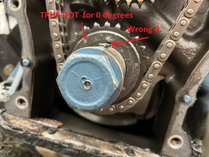

Also, should I put the crank sprocket on 0 degrees? There are several notches.

Everything should bolt up and you should need nothing else. I always degree the cam when done. I do not trust the garbage on today's market.
Should be no issue swapping the gear drive off. The cam may or may not be in the correct phase (degreed) with the crank gear on the "O" location. Also; with multiple keyway locations use the corsponding dot out at the edges of the tooth for the given key way location. Do not use the mark on the keyway itself to line up with the cam dot. The "R" location retards the cam. The "A" location advances the cam. Without degreeing the cam it is a crap shoot how close it is lined up. If it's a mild street motor you should be ok. A race motor needs to be degreed. Advancing or retarding the cam with minimal piston to valve clearance can get you into trouble.
Doug
This is added for dvw... :)
