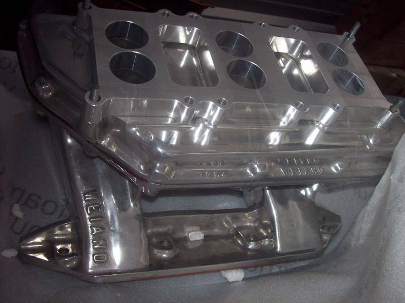

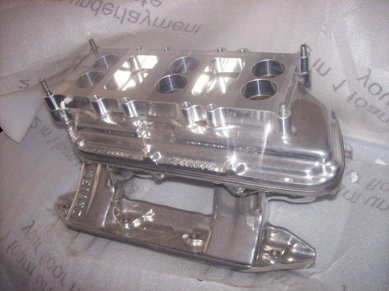

Let me say that I really like the intake, I haven't tried it out running yet, but I have read every page of information about it the internet has to offer, emailed the guy whose unique mods are pictured in the article on this intake in the Victory Library site, and got a reply much to my happy surprise. I have spoken with forum members who run it, including one who has run it over 10 years. I've also emailed the guy whose pictures of his Weiand setup by F&B for their direct port injection 3x2 throttle body setup first set the hook in me that I just can't shake loose from. The consensus is that this intake, hands down, makes the most power of ANY 6bbl intake, ever, other than custom fabbed units some guy in Sweden is running. I love the way it looks, and polished, it is stunning jewelry. (I wouldn't run the spacers, but this is the only pic of this intake polished I can find) Chromed, or "chrome powder coat" are options too.
Here's the top on my car as I would run it, without the spacers:

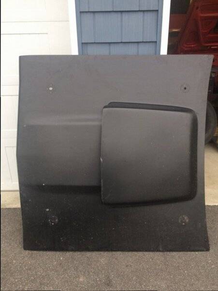

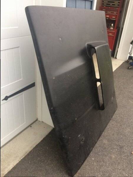

Ok, so an A12 style hood.
This w/70 "power bulge":
OR
this 69 style (made for a 70):

Bio, if you are determined to use the weiand tunnel ram (cause that is essentially what it is) the only setup that i see working, and still looking a bit like mopar stock (as opposed to a bigass snorkel or cowl hood , even though the seventy runner is the only mopar that has a remnant of a cowl on it) will be a aftermarket sixpack. All matte black hood would look great on your yellow runner.
Next problem is height. Most, but not all aftermarket sixpack scoops are taller than the original. That is probably exactly what you will need. Then, there is location. On the purple 70 in the vid, the scoop is about three inches farther forward on the hood than it should be,(good visual at about 50 seconds in, on the vid) and it looks only a little taller than stock. 493Mikes scoop is considerably larger than stock. This is probably what you will need to make the weiand work, to get some airflow space above the carbs. I like the power bulge hood, it retains the 70s lines, but you might need the scoop to be taller. Notice, the scoop is mounted closer to the windshield than the purple 70s hood, closer to the stock 69 location.

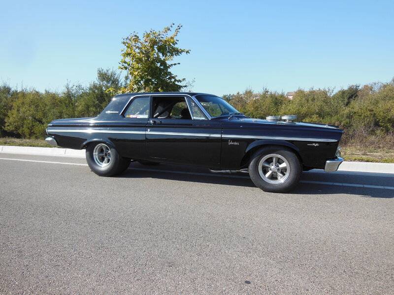

when running tunnel rams, u have very few choices between under the hood or out thru the hood. sometimes u have to find a middle ground on what works for u,,,,i did. those air cleaners would not fit under the cowl. i have 2 hoods, i will be switching back and forth this summer between scoop and no scoop.
Stage, i love your car, scoop or not. I have NO problem with a cowl hood on a mopar. (I just make believe its a taller 70 rr hood). The wheels and tires are perfect. Tho, if it were mine, it wouldnt be black, thats my own prejudice.
