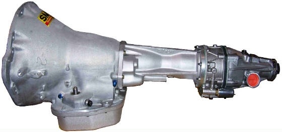

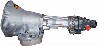

Not sure about the mods of fabrication, never used it...
there's a place that has shorty OD GV on TF's,
ain't cheap either but cheaper than that TCI 6x
I've never used them either, I was thinking about it a while ago,
but never pulled the trigger
http://smrtrans.tripod.com/smrtransmissionsintro/id32.html
{for some reason links not working, go to SMR Transmissions Shortie Overdrive}
check them out maybe too
good luck either way
I have that shorty GV unit. I made a dropped trans crossmember and only had to put a couple dimples in the tunnel. It came with a 90 degree speedo adapter. I'm putting it in my new build but will be using an aftermarket tunnel with a bunch more clearance.
