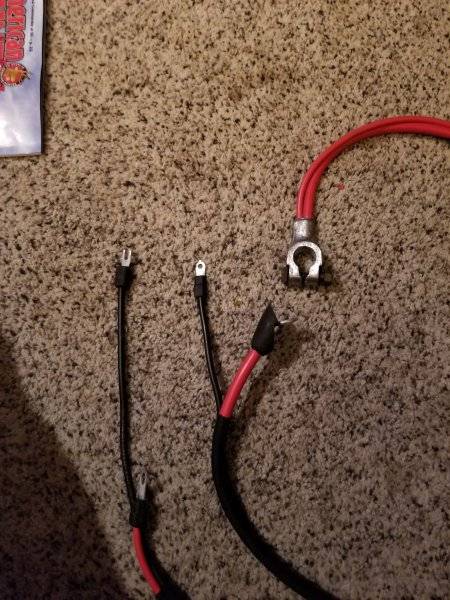

I need help with the positive battery cable connections where they all go. Much appreciated. Pat

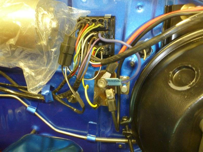

Left in your picture. They go to the starter relay on firewall, Red goes on the main power stud with nut, the black (should be brown if OE correct) goes on the small relay output terminal. Has a small head screw with a metal U plate over it. Spade slips under the plate. The two wires on the right are simply the main lug on the starter and the solenoid wire being the smaller one.

That is a battery cable for sure but it’s not a correct hemi battery cable

Thank you very much. You are a great help! Pat
