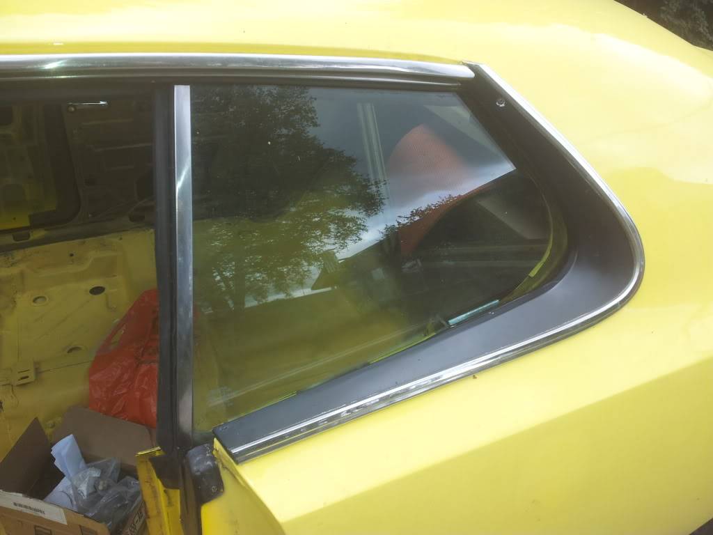

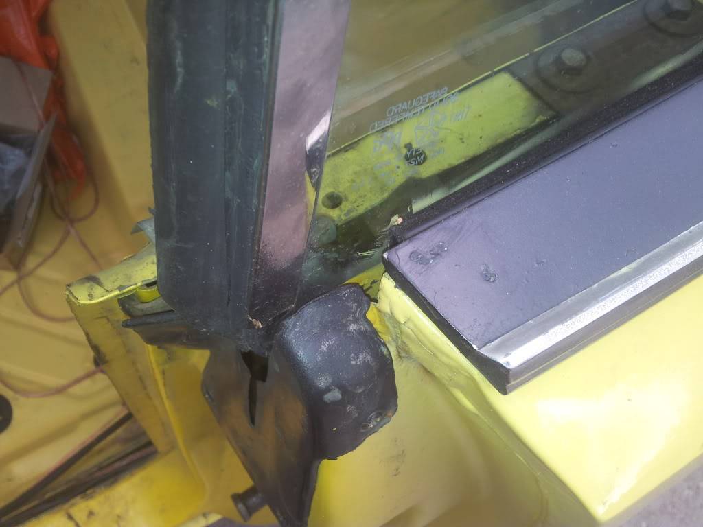

Hi,
I'm tired of water leaking during rains. The problem is quarter window's weatherstrip.
I've installed this kit
http://cgi.ebay.com/ws/eBayISAPI.dll?ViewItem&item=221014652669&ssPageName=ADME:L:OU:US:1123
But there's big gap between weatherstrip and quarter piller post end seal
Should there be one more seal in this gap?
Vent window fuzzys are not meant to really seal out water but the window seals themselves are, that seal looks old getting a new seal into that chrome is a trick I have to learn soon myself. :eusa_think:
