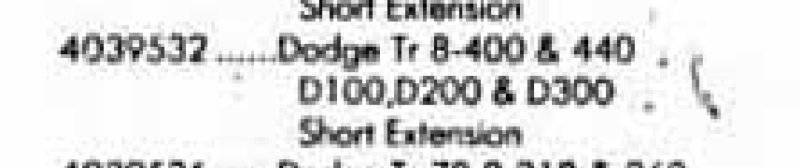

Numbers look like PK 4039532 6116 4058 Thanks for any info
Built on April 26, 1978. So that whole setup prolly '78 model year.
Would not be surprised to find 4 pinion planets in that trans.
